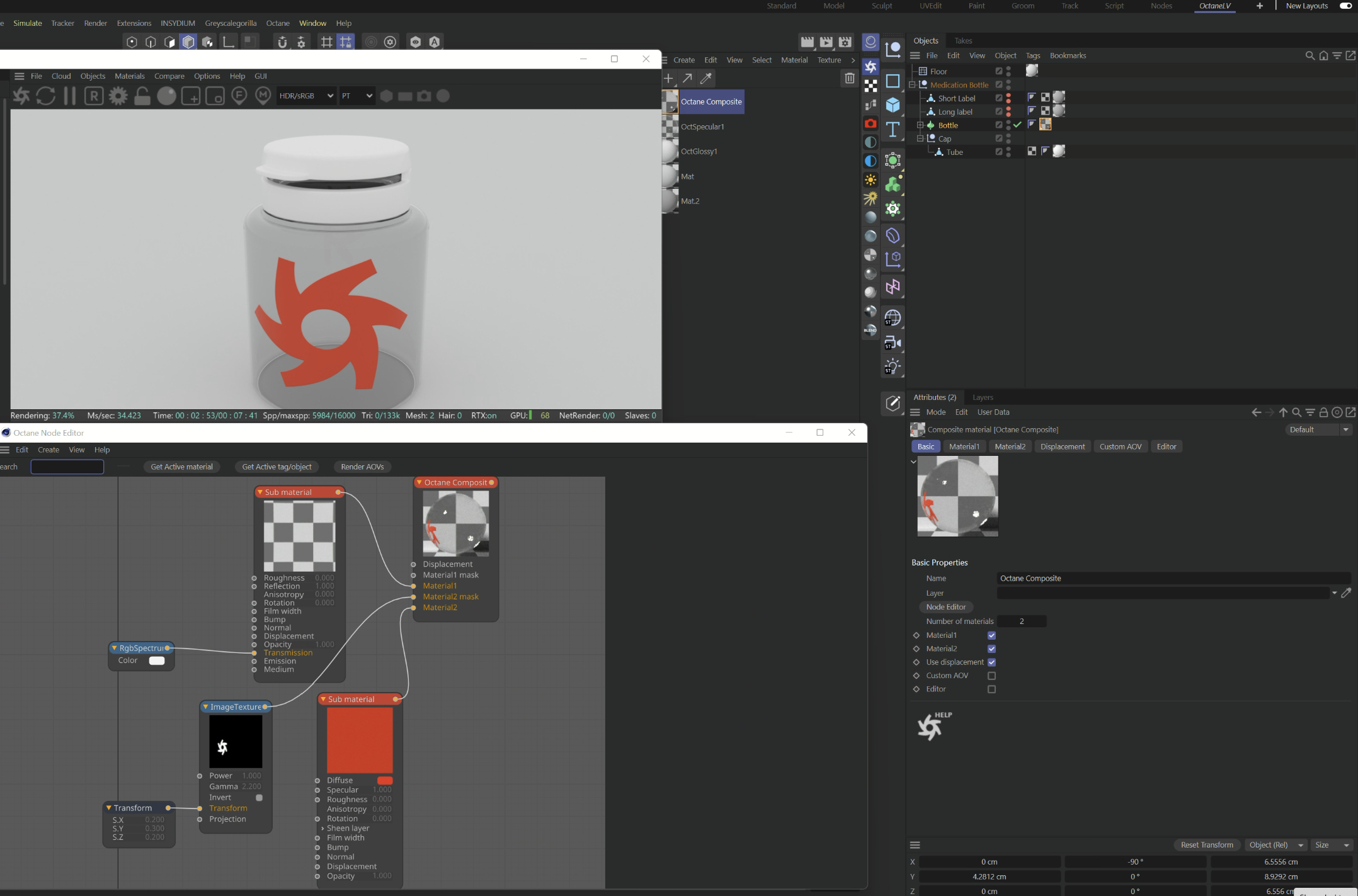

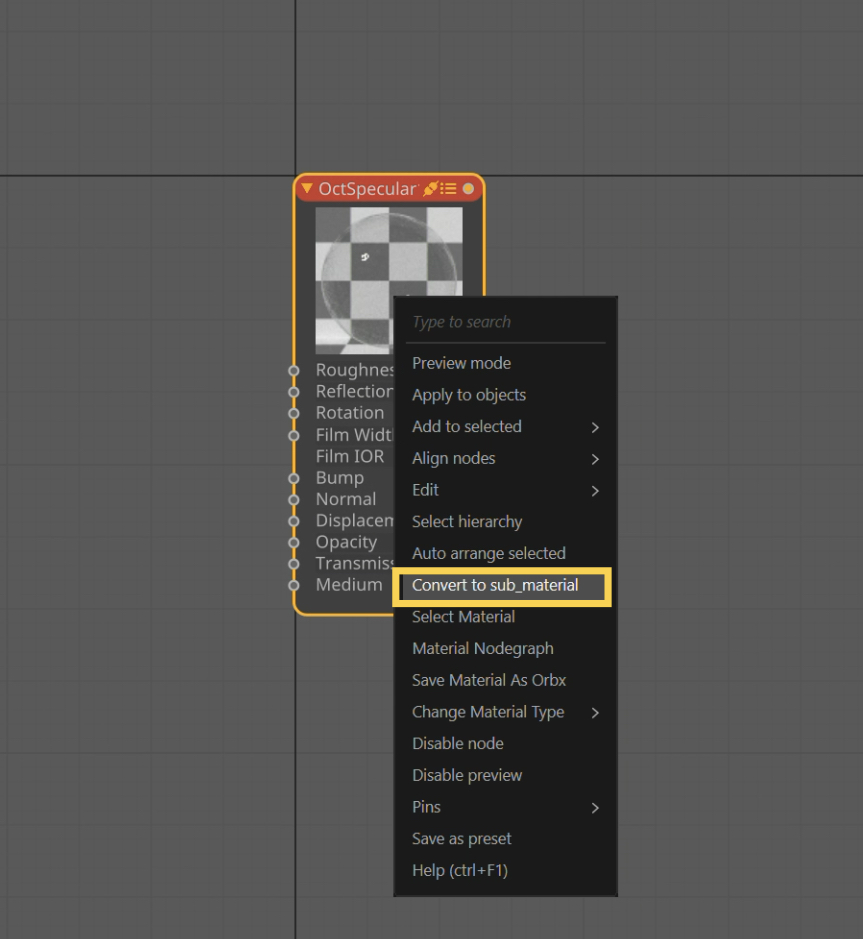

For example, you can start from a Specular material for the glass, then right click on the material node and choose the Convert to sub-material command:
And use the texture in Opacity of your label material in the Mask pin of a Composite material, between a Specular sub-material, and a Glossy sub-material:

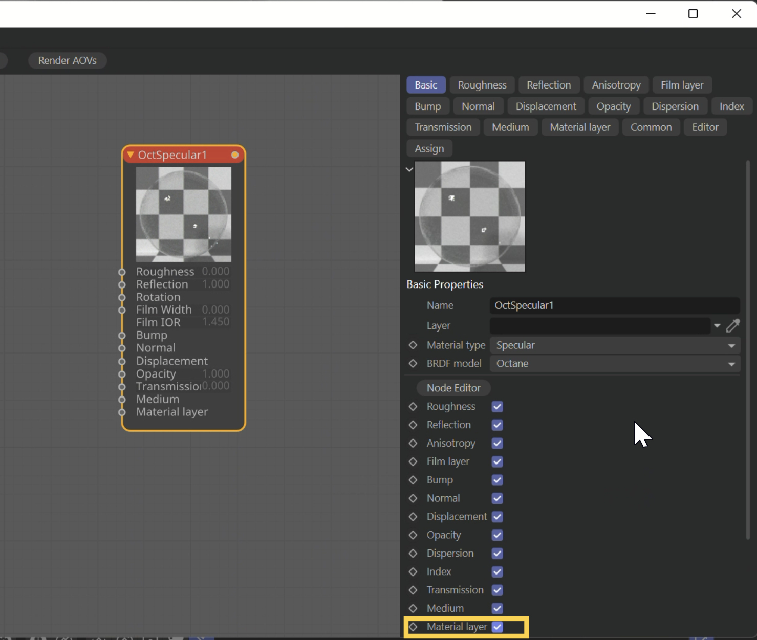

Or start with a Specular material, and in the Basic tab enable the Material layer option:
Then create a Layer Group with a Diffuse and Specular layer, using the label opacity texture in the Layer Opacity pin of both layers:

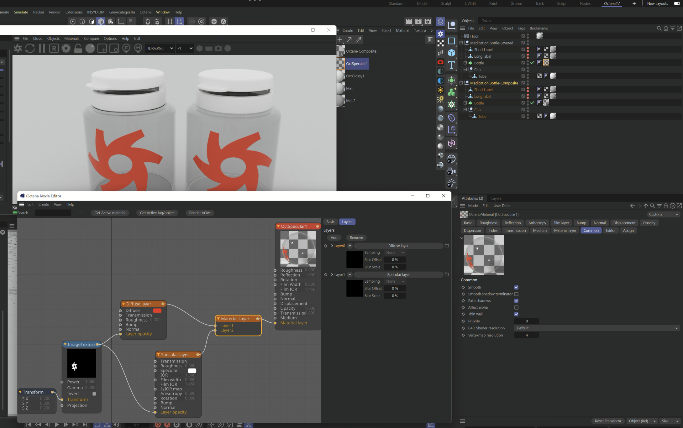

That is incredibly helpful, thank you so much - works perfectly as far as the layering goes. My apologies for a delayed response, I thought I had notifications turned on for this thread, I've done so now!
This technique has raised one small problem that I can't seem to figure out - I've included a screenshot!
Any idea why it's repeating like that? I've tried variations of different UV maps, etc.. I'm still very new to this, so not sure what things to try
