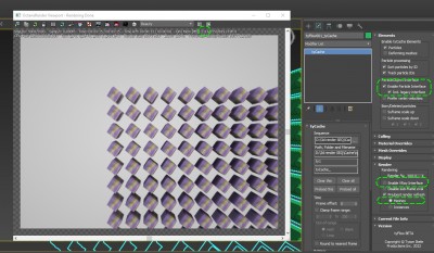

I'll try to explain in more detail what the problem is.
1) https://dl.dropboxusercontent.com/scl/f ... 5n5c5&dl=0
Octane render of tyFlow as instances. Vram used is 1315 Mb. Everything works except Mapping. Scene evaluation time: 1 sec.

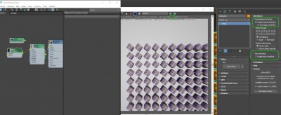

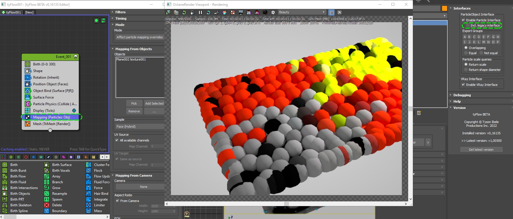

2) https://dl.dropboxusercontent.com/scl/f ... 2u78t&dl=0
Mapping works if I disable the "Incl. legasy interface". But Vram used is 3114 Mb. This means that it is no longer an instance, but just a single mesh. Scene evaluation time: 10 sec.

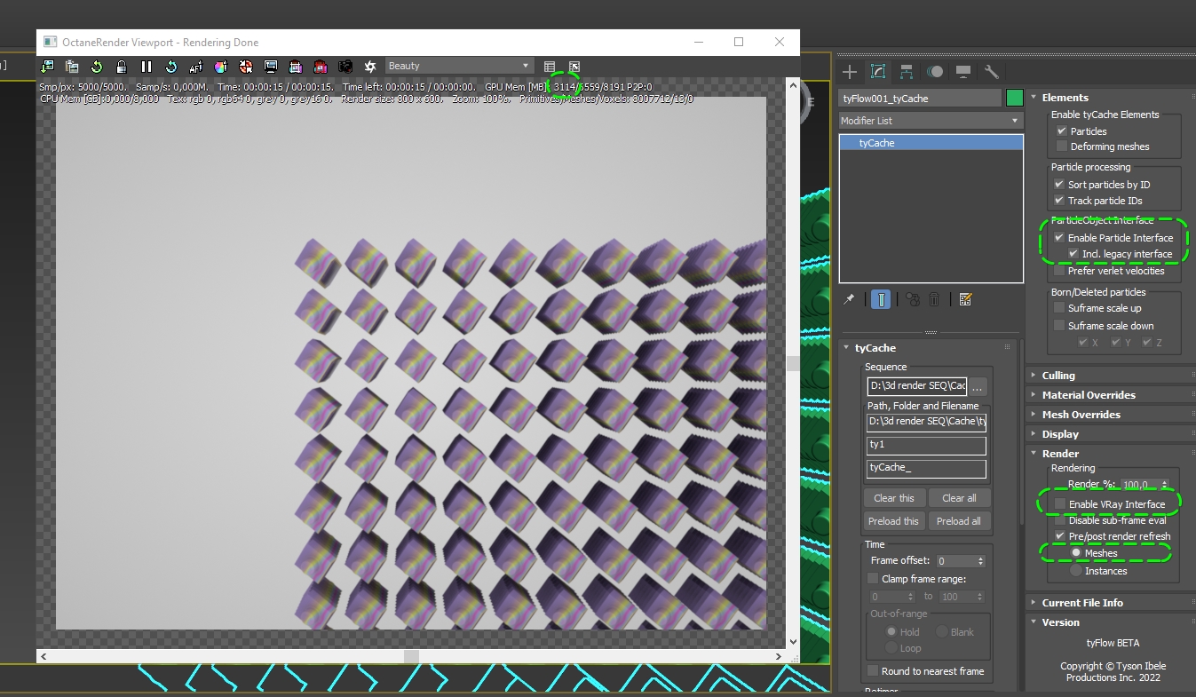

3) https://dl.dropboxusercontent.com/scl/f ... 06w24&dl=0
Render of TyCache. I can't even get a result like the first option. Renders only as meshes, not as instances.

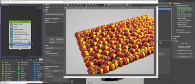

4) https://dl.dropboxusercontent.com/scl/f ... hy8oi&dl=0
V-ray work fine both in tyFlow and tyCache. Fast, with mapping and instances. Maybe we need some button like "Enable Vray interface" but for Octane instances?
