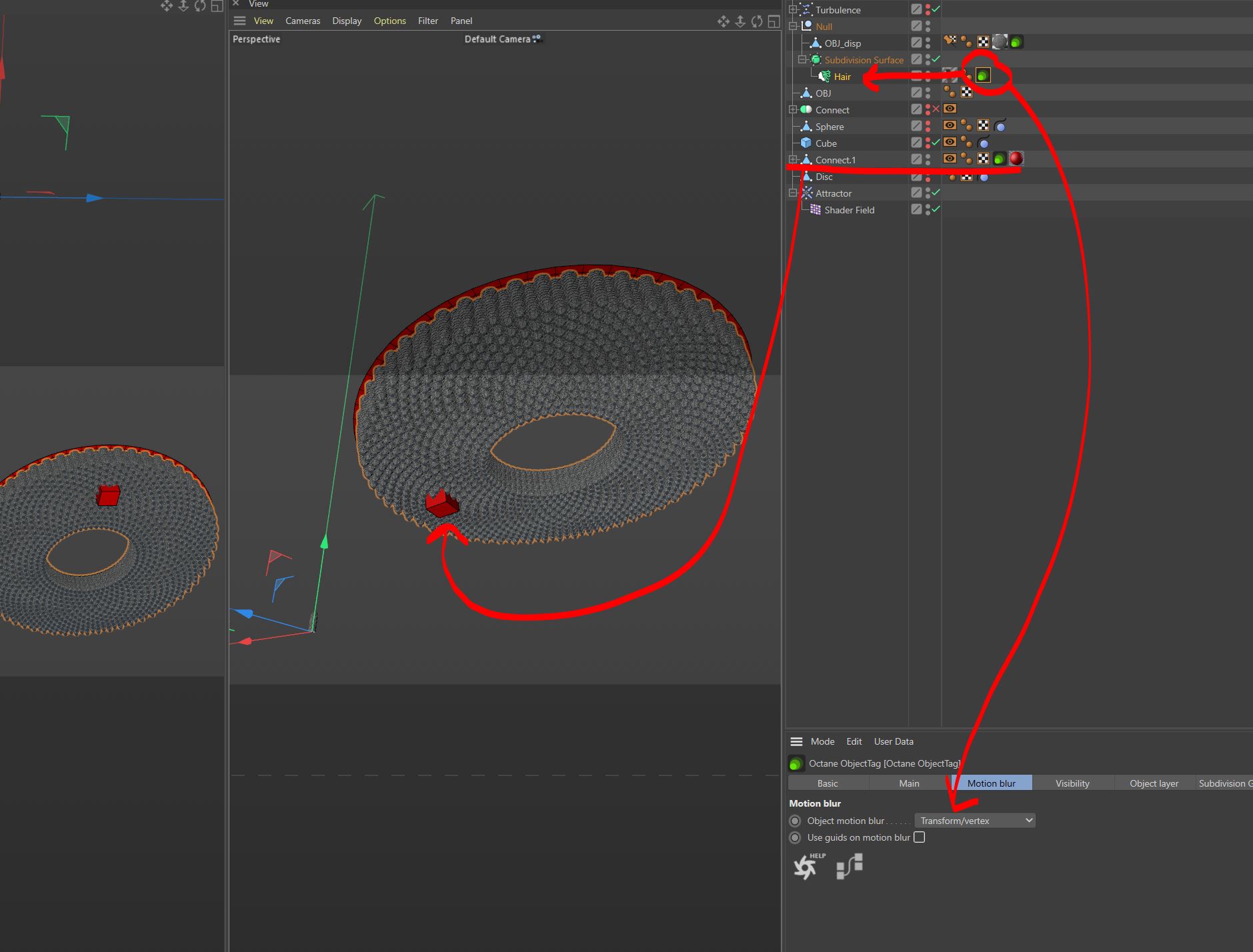

This thing u see is a spinning mop, I applied "Add Hair" on a circular spinning plate. + (instance obj on to hair)

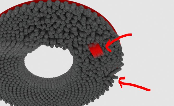

the red cube is parenting to the spinning red plate. when I turn on motion blur, the instances object on hairs have no motion blur, u can see only the cube has motion blur.
I wonder what I did wrong?

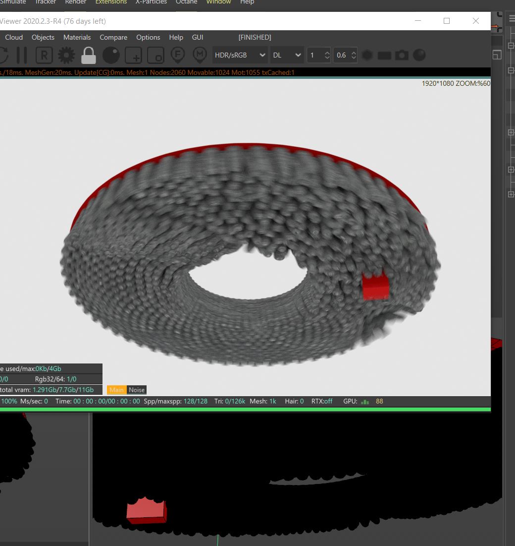

oops! I found the problem. but I dono why?? haha
When I uncheck displacement in octane material, the motion blur works! is that a bug?
I had Displacement map for static, but if is motion blur. uncheck the displacement map solved my problem.
Posts: 10606
about Displacement and motion blur, it is supported only with Vertex Displacement, Texture Displacement doesn't support motion blur.
Change the Displacement type to Vertex and add some subdivisions, until you see the effect you want.

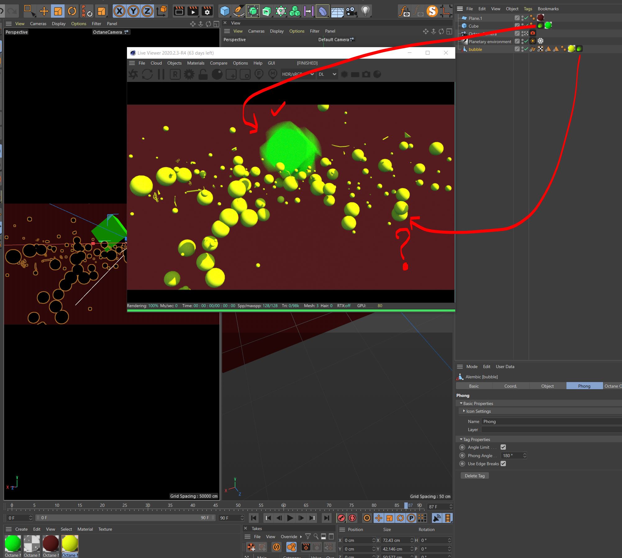

in C4D, I simulate a bubble using emitter, then I convert the animation into alembic files.
U can see in the picture, the cube has motion blur, the bubble which is an alembic file has no motion blur.
Hope u guys can help me with this. :(

i have this TEST2.c4d sample. when is rendering only the cube has motion blur.. but not the bubbles
TEST2.zip
(94.29 KiB) Downloaded 141 times

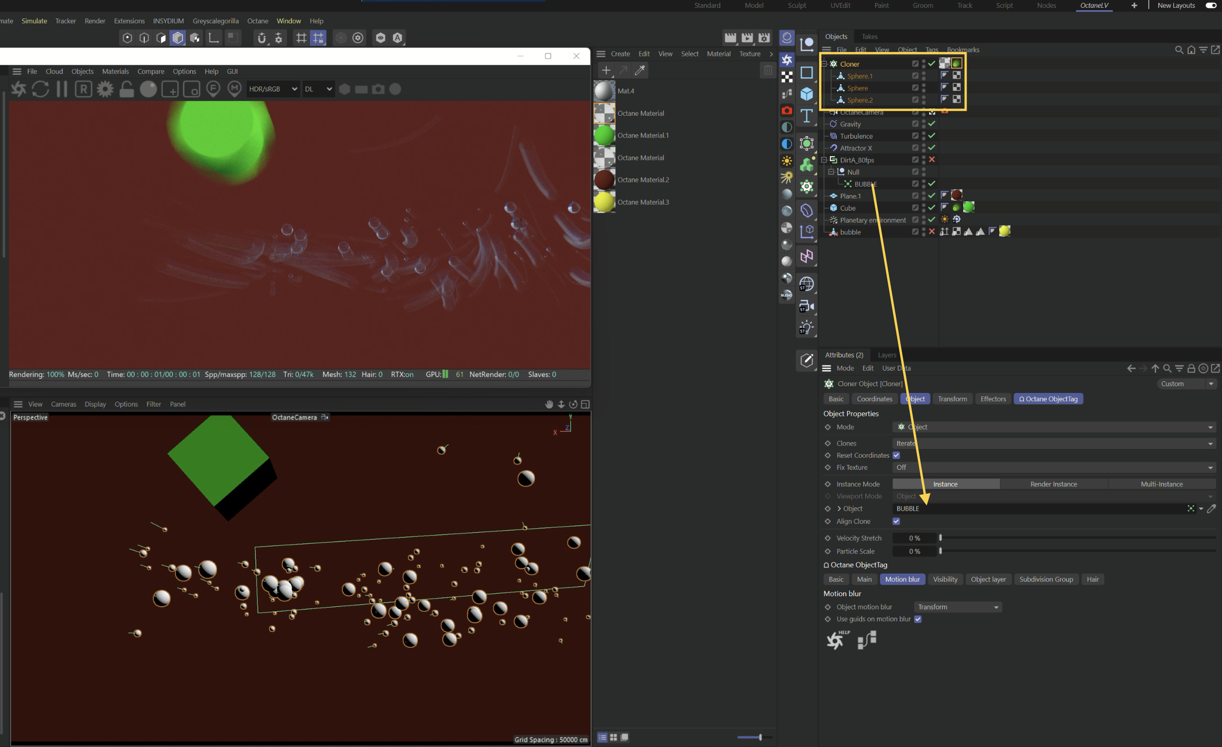

if you use a MoGraph Cloner pointing to the emitter, motion blur works in simple Transform mode:
TEST2_b.7z
(147.78 KiB) Downloaded 158 times

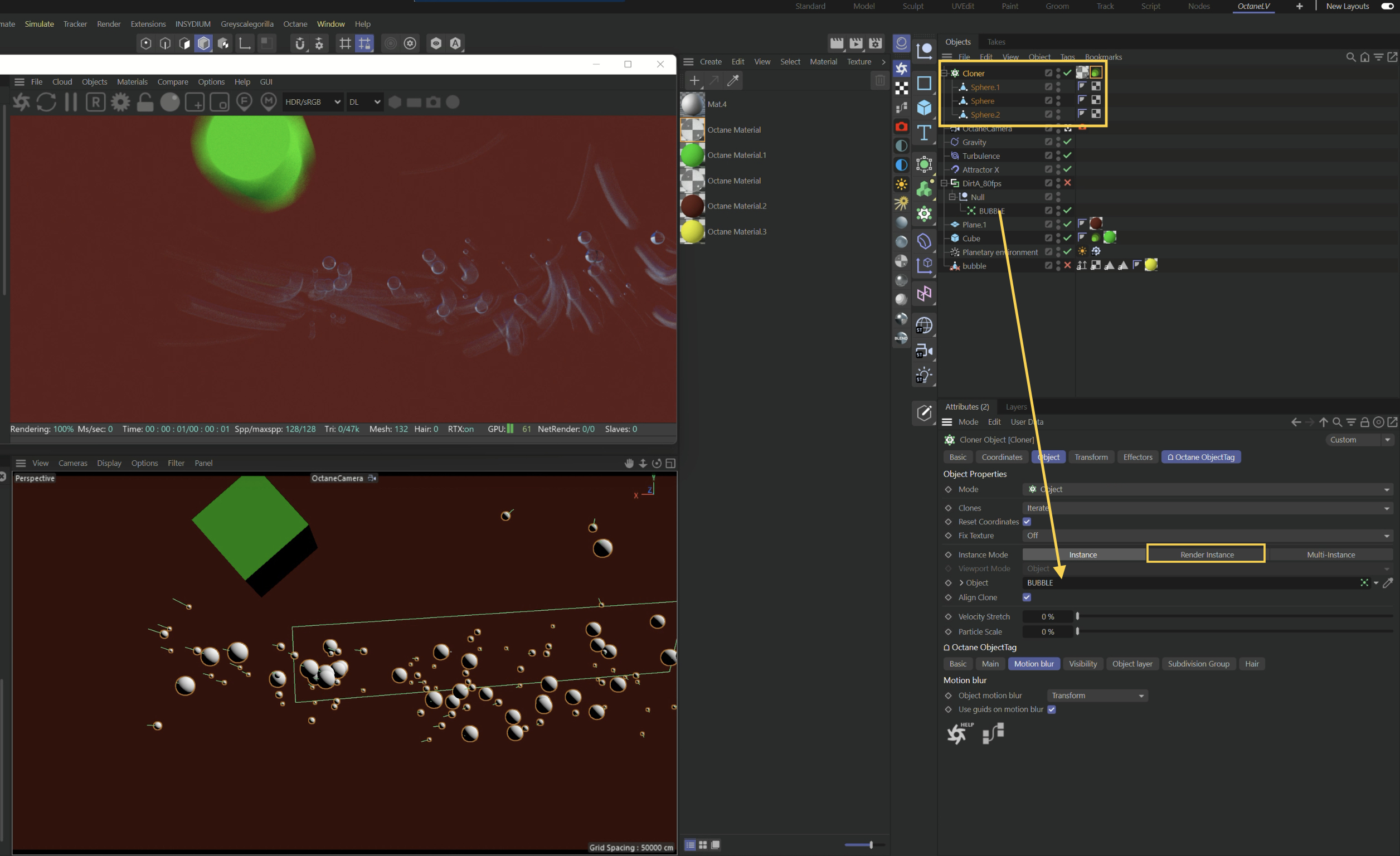

Posts: 10606
Sorry, it is Monday morning :roll:
I forgot ot enable the Render Instance option in the MoGraph Cloner :D
TEST2_b2.zip
(167.59 KiB) Downloaded 153 times
