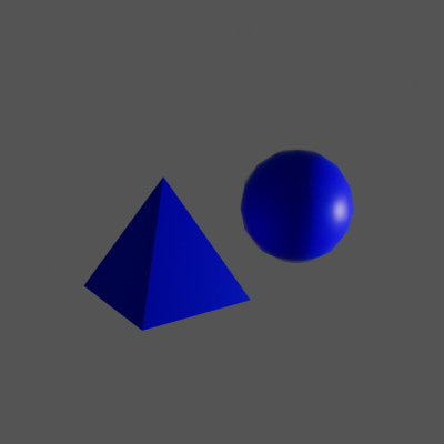

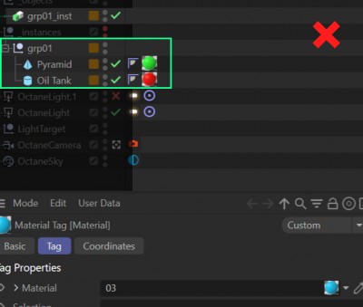

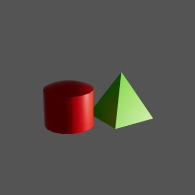

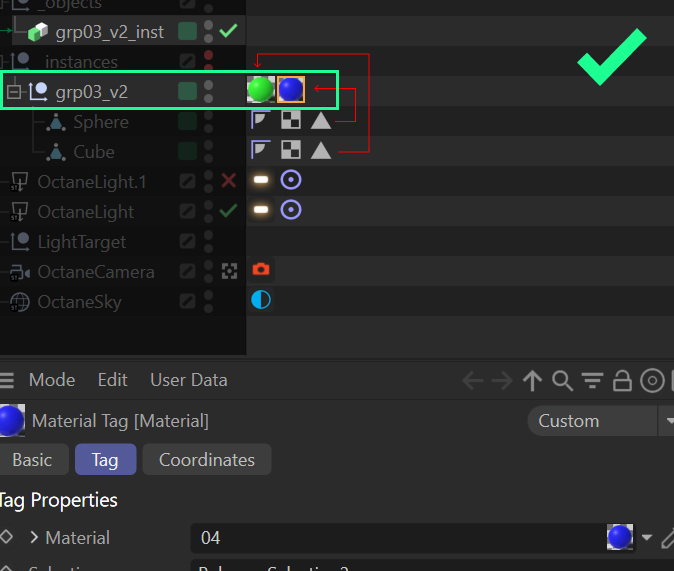

1) make a group object under a null and create an instance for it
2) assign materials to child objects under that null
3) repeat this a couple of times

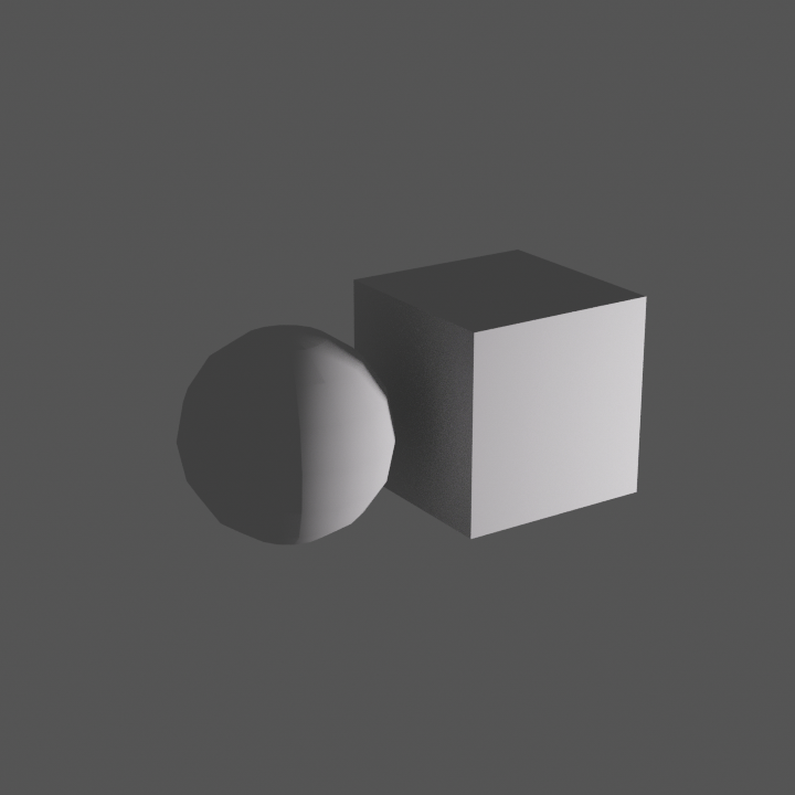

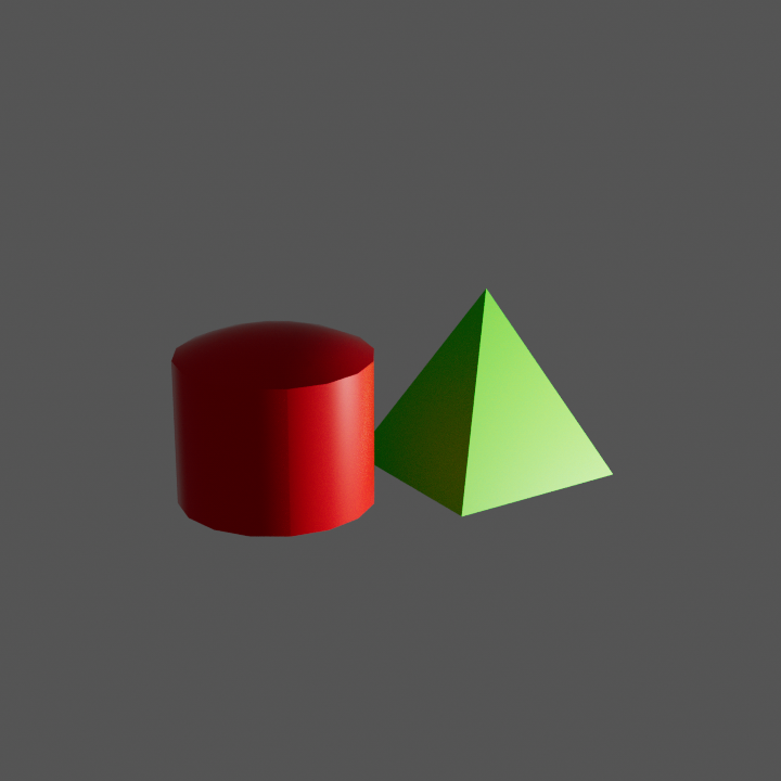

4) use takes to get solo renders for every instance objects
If you activate "ignore unused materials" option, Octane totally ignore materials under null objects.
But if you use materials for null objects, Octane renders only material for null object.
Octane does not detect materials in the scene, I guess? Is there any way to fix this?
