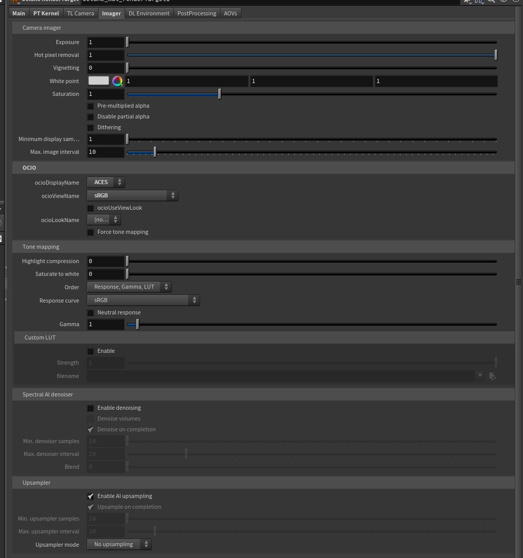

- I dont know about mpplay and its settings, its all default.
- I have ocio set in windows env and everything works perfect.
See attached for camera imager.

So it seems u need to reset mplay settings randomly, so it gives u the aces button where u disable ocio cause its double or something and then u can save.
Can we fix all these? Can we have an a/b comparison into the ipr?
Can we save from ipr with proper gamma also? Can we at least fix that the png from ipr to be saved proper while aces? thanks
