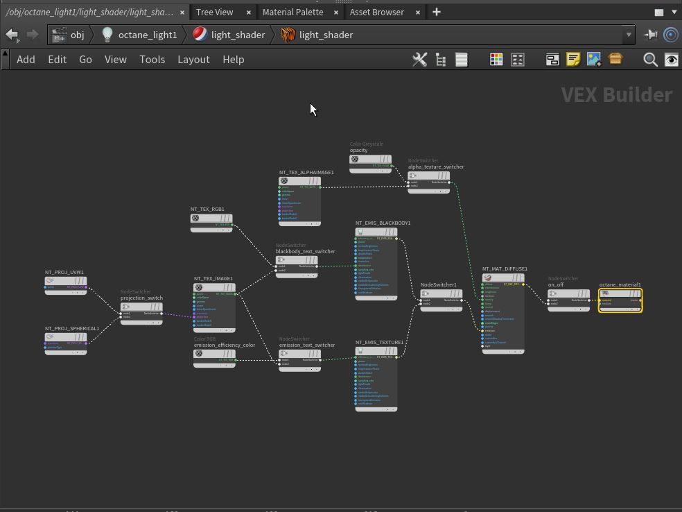

How can i do that in lights? In c4d im using an OSL that octane has that i connect to light distribution.
Cheers
juanjgon
Posts: 8867
Location: Spain
In Houdini you can probably do the same if you edit the light shader available inside the Light OBJ HDA.
-Juanjo

elsksa wrote:Standalone user, curious to know. It is possible via a disc primitive geometry with an emission (diffuse material) shader with the spotlight 'texture node' plugged to the distribution?
Similarly to this setup (Spotlight section).
Yes. Octane for Houdini is pretty much the same as Standalone.
