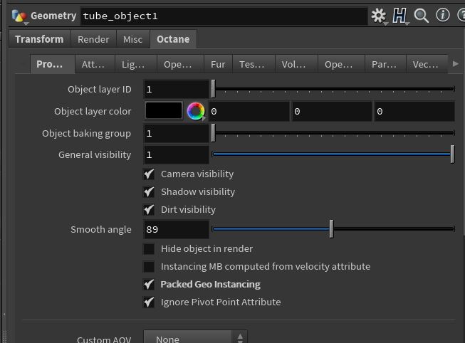

When I have a particle simulation and I want replace on render time with a custom object, how is that done in H?
In c4d i use octane tag and throw whatever objects i want in there.

There's a shelf tool available for basic instancing on particles, Particles tab --> Instance Geometry on Particles.
Worth a try.
Worth a try.
I wanna know what is the way houdini handles this situation in the most efficient way. Otherwise I can simply copy to points i guess. So is there an octane object tag?
You can indeed use the copy sop for instancing, but you need to enable the "Packed Geo Instancing" option in the Octane OBJ spare parameter. Of course, you can also use the conventional Instance OBJ node, or the "instance" string point attribute pointing to the path of the object to be instanced.

Thank you. Could you show me an example with instance node? never used it before. Cheers
this cover it pretty well
https://www.youtube.com/watch?v=ZanEfWQ2NrQ
