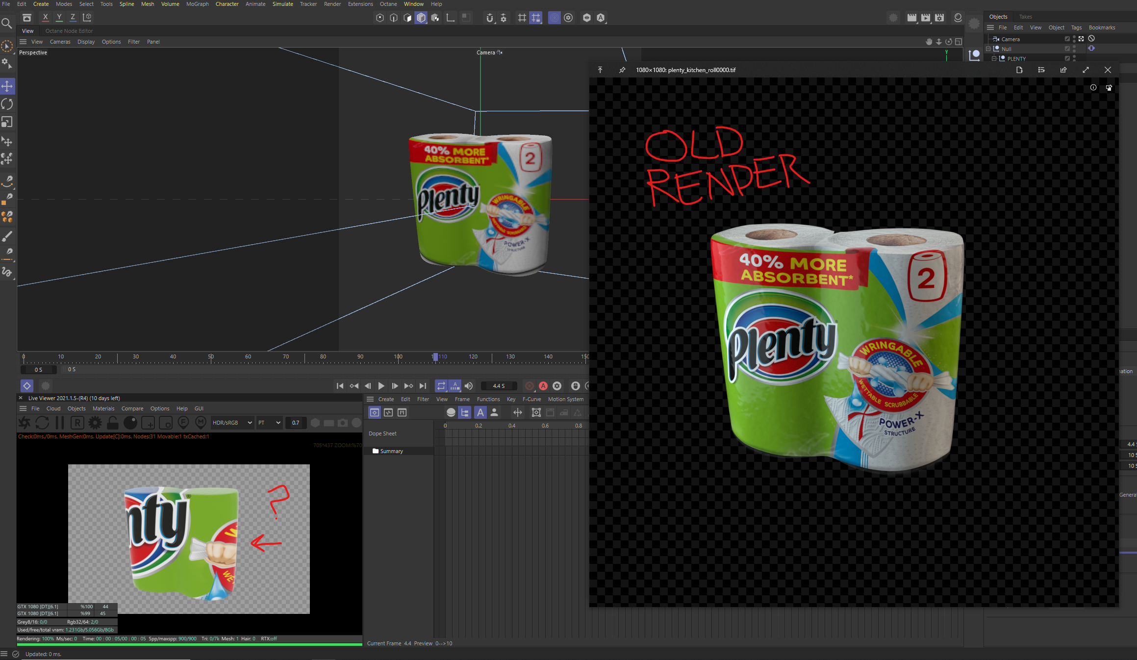

Hi Aoktar, I have looked at this issue too - here is a test file that shows the issue. Tried both builds above. https://we.tl/t-rqxOEX5Mdp
Its not using any of octane projection nodes on the material- just passing thru C4Ds camera. It used to work and replicate the C4D viewport exactly but now doesnt. Not sure why as its so simple.

I can't understand what's wrong here. Could you please show your expected results?

Here is a pic of the old render (which matched C4D) and the way the same file looks now (viewport).

I'm checking it...
With old build we was using an emulation system by converting cameramapping to uvmapping by some internal functions. It had some handicaps like distorted results or usage limitations. Then I've added accurate and native way to do this by Octane Projection nodes. But convert function seems like that doesn't support camera FOV. Your camera has different numbers on FOV than default values. This is making that projected image seems different. You can see how I'm right by switching to default FOV. I'm looking for a formula to convert FOV to scale factor.
