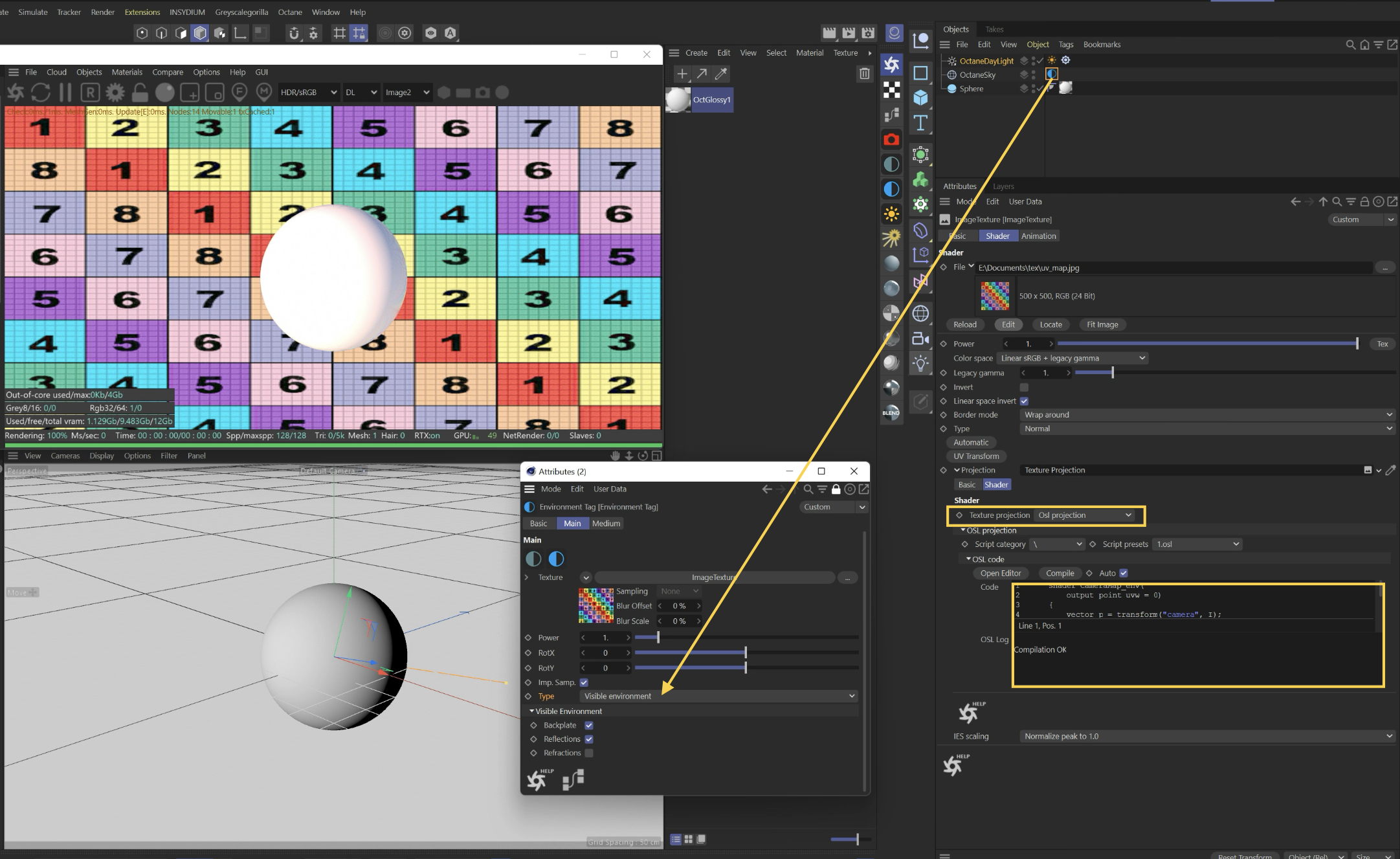

Posts: 10590
Ah, ok, you need to use an Octane Environment node, then set the mode to Visible Environment, then load your texture in the Image texture node, add the Projection node, change it to OSL projection, and copy paste the code you want in the node:
Here is an example scene:

Okay, it seems I got it working, much appreciated!
