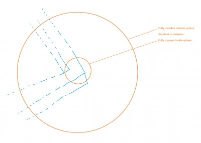

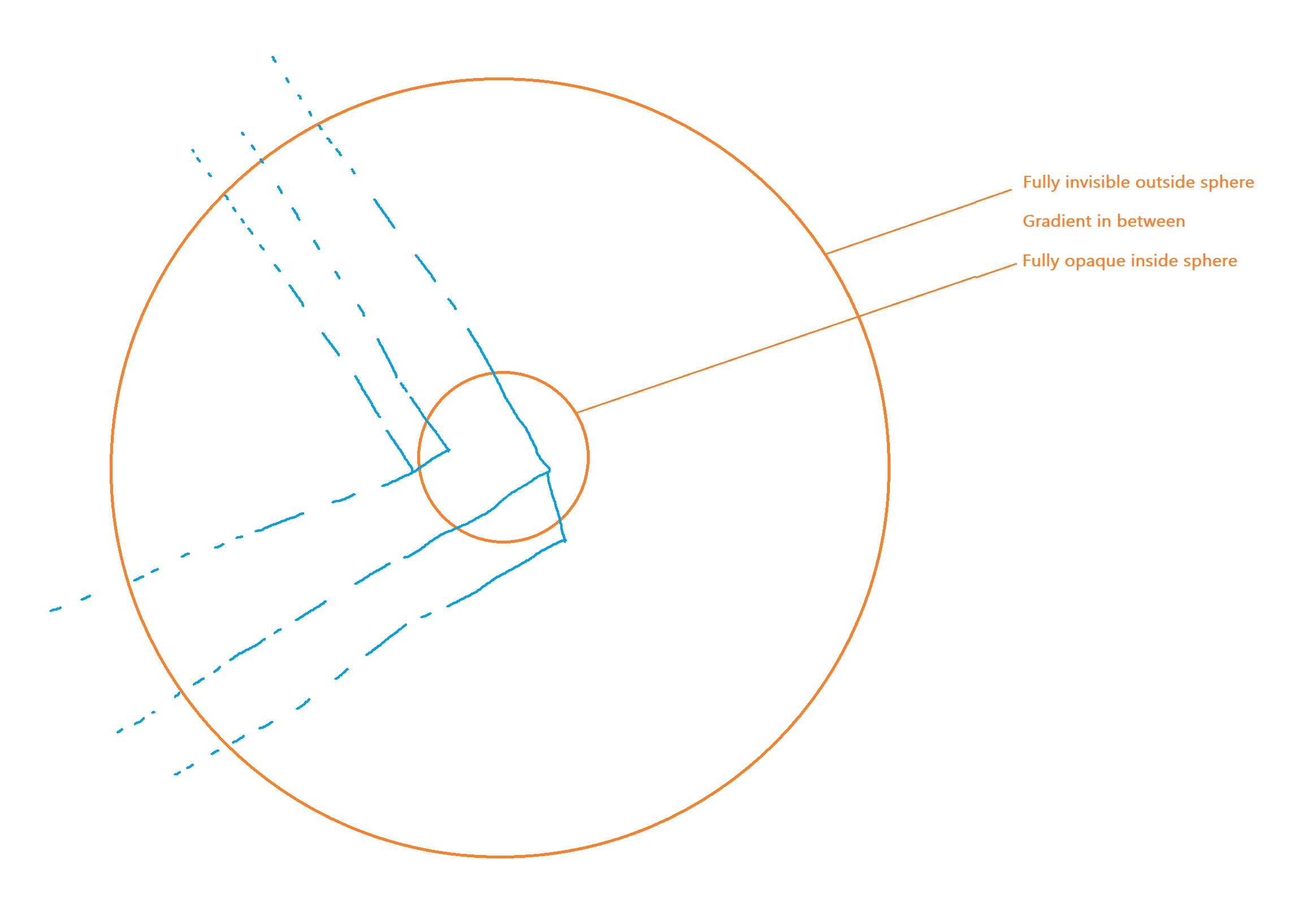

I'm trying to create a transparency effect that has a gradient sphere. Basically whatever elements are close to the inside of the sphere or an origin point/location/datum will be more opaque and get more transparent as they get further from the focal point until they disappear completely.

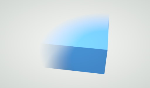

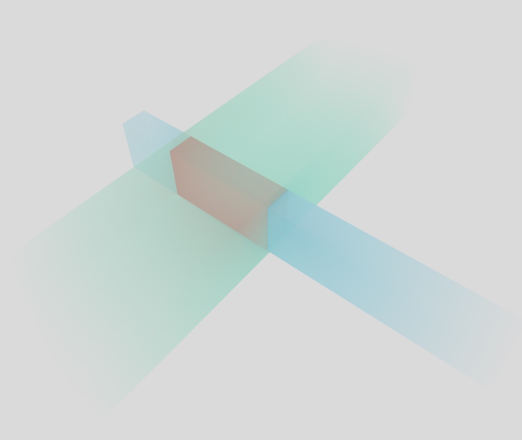

In 2022.1 you can use the "Spherical field" texture and plug it in the Opacity.
The "falloff radius" will be your outside sphere and the "core radius" will be your inner, opaque sphere.
spherical-field.orbx
(28.26 KiB) Downloaded 154 times
