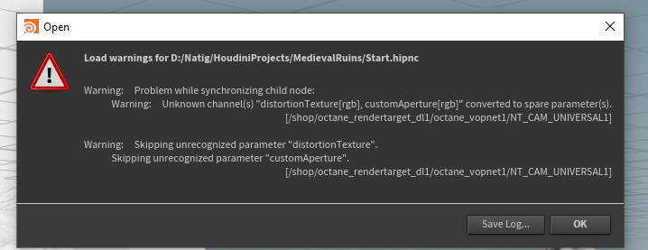

Hi, I'm constantly getting these warnings, is there anything I can do about it? Thanks in advance.

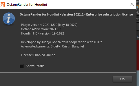

What plugin version are you using? I think that this problem had been resolved in the latest build:

Hmm, but perhaps the scene (and the render target HDA embedded in it) comes from an older version, right? I think that the render target HDA included in the latest build doesn't have this issue if you add it to any new scene.
Anyway, I know that it is an annoying issue, but it is safe to ignore it. It comes from some deprecated parameters in the camera nodes that had not been updated in the render target HDA.
