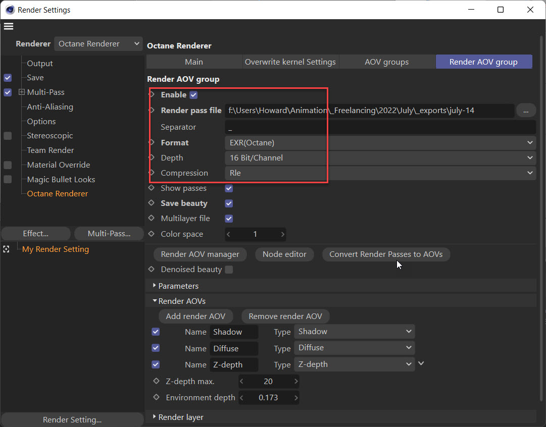

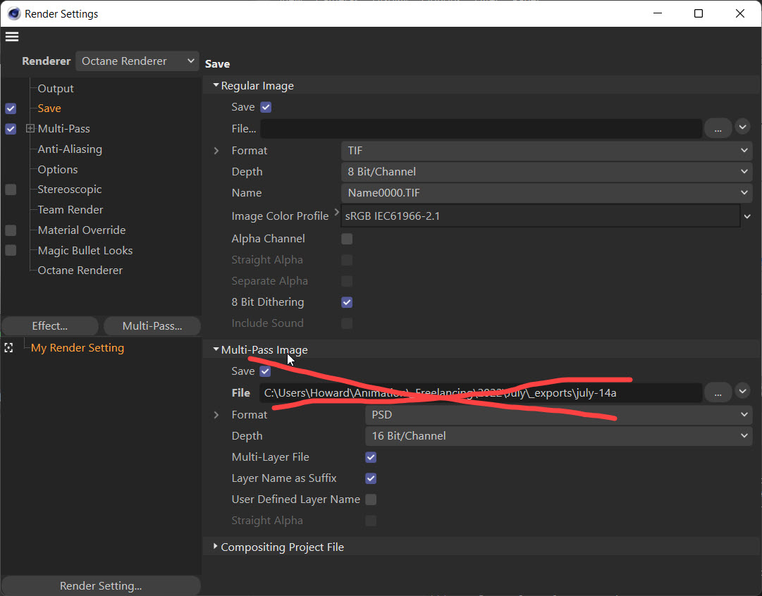

I don't know OctaneX but It's working well with latest windows builds. I advice to update to latest stable. Also do not use C4D's renderpass saving section. Use our render AOV outputs as in picture. And use Octane-EXR for expected results.
