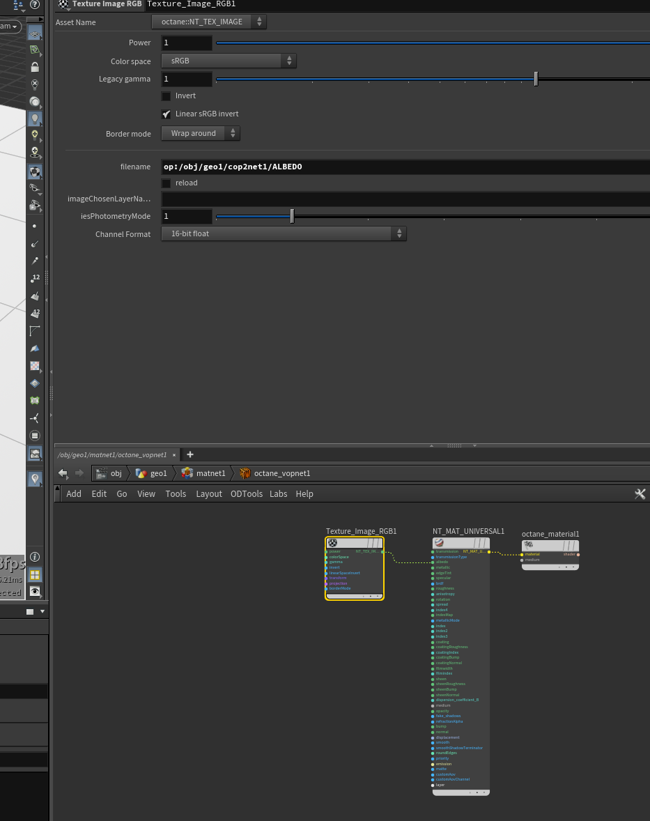

Hi, Attached a simple scene illustrating an instant crash when hooking-up textures with the op: expression in Octane Texture RGB filename.
This used to work before, now it crashes in all scenario's.

Resolved: Octane isn't yet compiled for the new production build, probably why error presisted. Works fine in previous production build 19.0.622.
