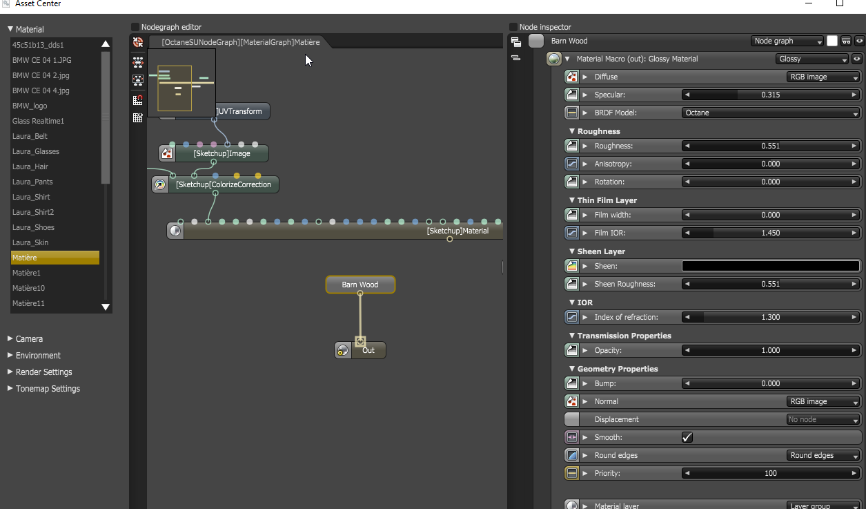

The new SU is completely rewritten. And we do need to use the Asset center to control the Octane nodes and shaders.
Yes, Live and LocalDB are planned for the future release.
As a workaround please drag and drop the LocalDB ORBX file in the node editor and connect to the existing Out node.
