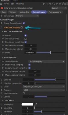

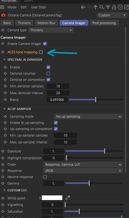

Hi!
just come across this check box on Octane camera tag, so I wonder what does it do?
jayroth2020
Posts: 495
Joined: Mon May 04, 2020 7:30 pm
Looks like this one snuck in before I released the docs and I missed it, sorry. I will include it on the next update (several things in my queue at the moment). It appears to activate ACES tone mapping for that specific Camera tag. Here is a general description of ACES/OCIO to review those features:
https://docs.otoy.com/cinema4d/ACESOCIOQuickStart.html
