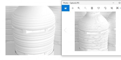

I can render with the focal length at 35 OK, but soon as I up the focal length to 300 I get facets on every surface.
35 focal length and 300 focal length
How do I solve this?

elsksa, you are awesome.
Based on the minimal info I gave you, you nailed it. I just upped the ray epsilon to.1 and job done.
Thank you so much.
