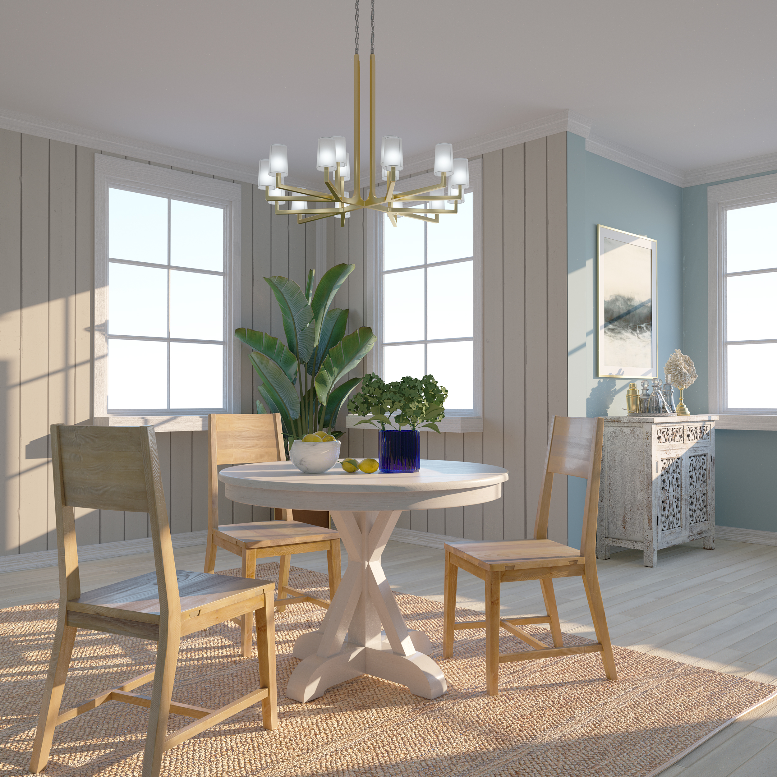

Hello, I recently became renewed in my interest in Octane as a render solution.
Last time I tried was in 2015 and I was in between Vray and Redshift due to the places that I worked requiring knowledge of these for finishing work.
I wanted to return to Octane since I have seen more Octane work showing up everywhere and remembered it was an unbiased render engine.
I took a scene that was made with Vray and converted it to Octane to see what the learning curve would be converting people from Vray or Redshift in case there was consideration from management for adding Octane to our arsenal at work.
Since I could only get Octane 2019 to run on the VMs we have due to some conflicts with Xeon CPU sets.. and also the limitation of Tesla T4s for GPUs I wanted to ask questions about
functionality in the latest editions vs the 2019.1.x versions I can run on the vms.
I also converted a car scene that I can't post here due to NDA. In the car scene in Vray or Redshift I can setup a Vray area or redshift area light to be textured with an EXR.
We use a few softbox textures on the lights themselves so that there isn't just a flat white square in the reflections of the car panels. One major aspect of lighting with the exrs besides being able to project diffuse and specular breakup with the exr texture is the fact that the lights in Vray and Redshift have slider/attributes for separate Diffuse and Specular contribution.
This makes it so that I can push a lot of diffuse to light the car diffuse panels but then reduce the specular contribution so that the reflection appears a bit more mild and less blown out, giving the panels a much more elegant reflection shape from the softbox exer.
In Octane 2019 I could not see a way to separate the light diffuse and specular contribution with a slider using an actual light.
I had to instead create a geo light that used the Octane Texture Emissive in an Octane Diffuse Material for the diffuse separately from basically the same light cloned... then place the specular contribution light slightly behind the diffuse whilst not casting a shadow and only contributing specular. This had to be made quite a few times in order for the lights to work the same way I use them elsewhere in Vray and Redshift.
I know Octane is an unbiased renderer so perhaps that is why the lights have no separated values for diffuse spec but I think it would be useful, since you have the separate checkboxes, to also have separate diffuse and specular contribution % sliders.

Octane 2019 RenderTest_Maya

Hi Intuition,
Sorry for the late response.
We are glad to see you back. Please find our quick response to your queries!
1. Is there a way to texture the actual light with an exr vs using the emissive texture on geometry?
-> Octane emission nodes have two texture inputs, one for putting an image on the geometry (eg. a TV) and one to create an emission pattern (eg. spotlight or projector).
These are respectively the Texture and Distribution inputs.
2. Does the latest versions have light attributes that allows for tuning the diffuse vs specular contribution % separately?
-> unfortunately, we do not support tuning the diffuse vs specular contribution % separately.
-> We have created an internal ticket to investigate if we can implement native Maya light linking, Texture repeating, baking and Solo mode.
Maybe the texture repeating is what we have in Octane Standalone. We will get more information asap.
-> Unfortunately, the Substance Designer SBSARs is not supported yet.
cheers
