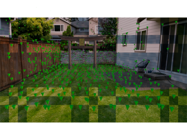

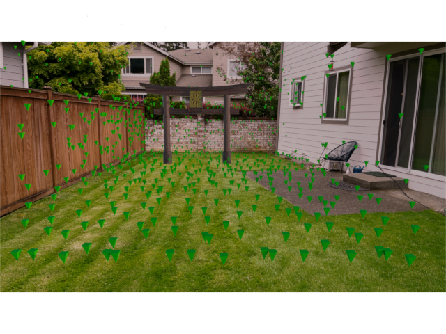

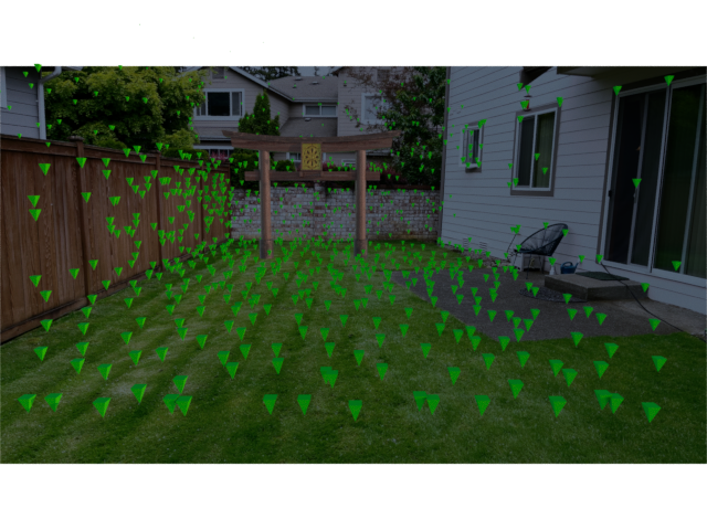

Trying to do a test render in Maya 2023 and latest Octane, and I get different brightness or patterns between frames. I'm using a Quadro P4000 and Quadro K4000. I've tried turning them on and off but I get the same render output. Any ideas on what causes this?

Sometimes Gets Mixed Pattern Frame #9
Renders Lighter Frame #2
Renders Darker Frame #1

Hi Jeff,
Thank you so much for the post.
It seems like the issue is related to Syntheyes's polygon image plane attached to the tracking camera.
We have responded to you on Zendesk with a sample file replaced with native Maya Image plane.
Please let us know how it goes!
