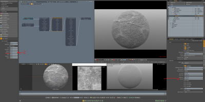

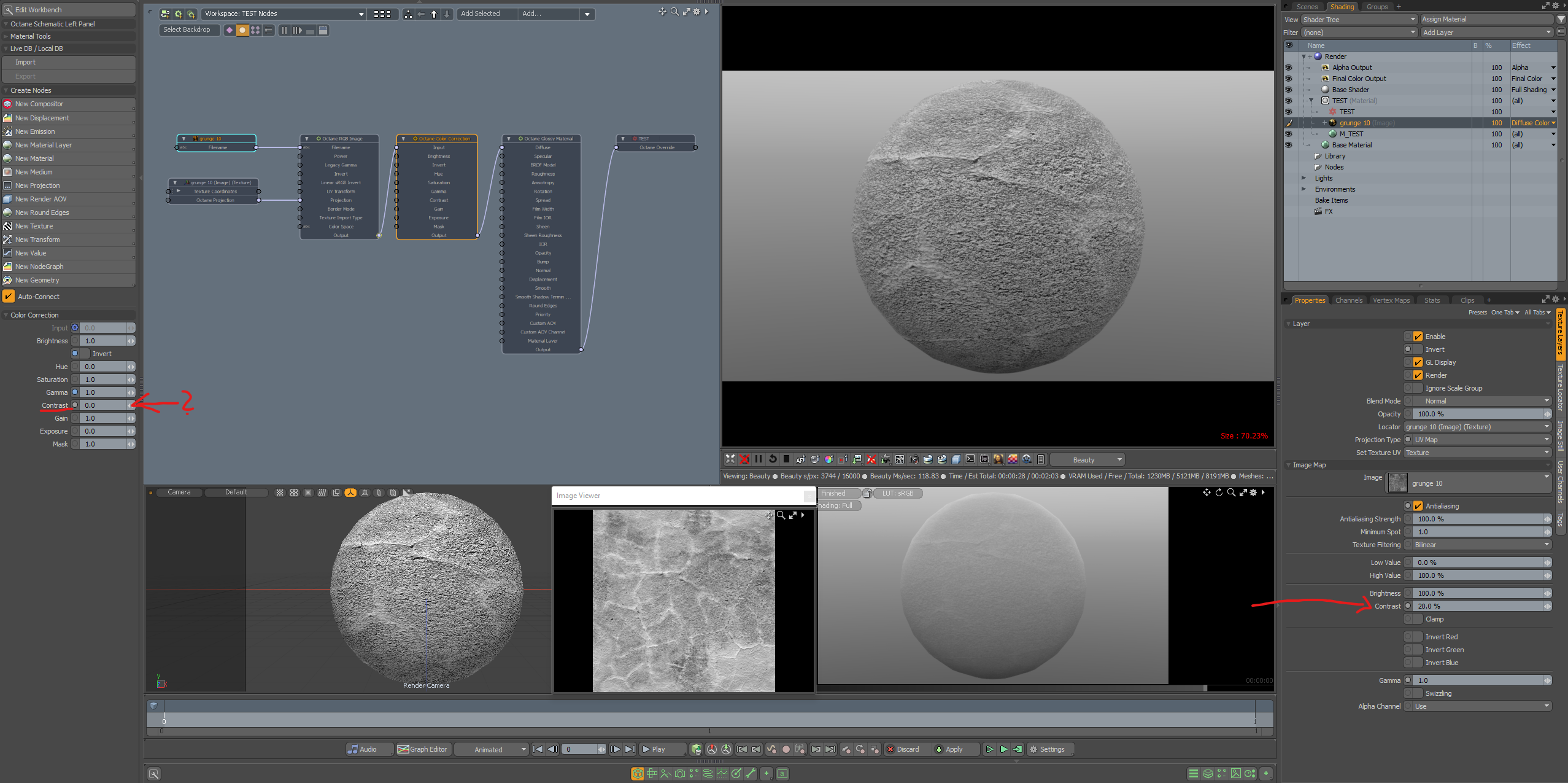

the Contrast Setting of the Octane Color Correction Node doesnt work with the texture i plugged in.
No matter what value I set, it has no effect. Is my setup wrong ?
In the Modo Preview I simulated what I would have expected.
using:
Win 11 / Modo 16.0v.1 / Octane Plugin 2021.1.5.186 / Nvidia 512.59

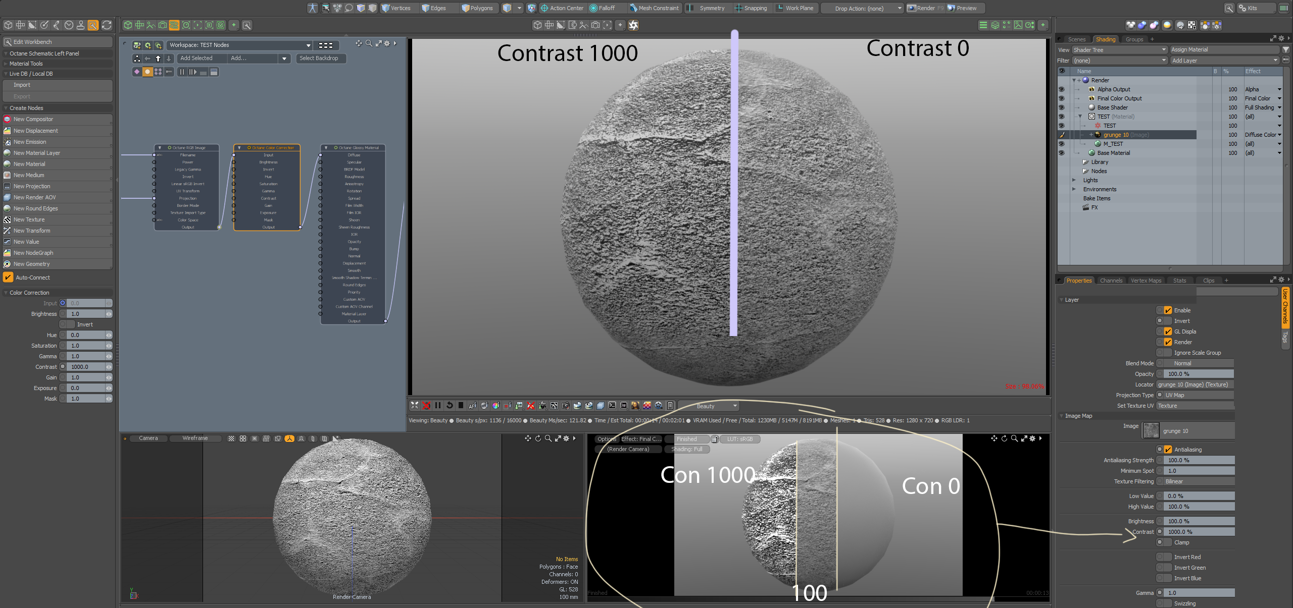

The contrast setting in the plugin's ColorCorrection node [v2021.1.5.186] is used to increase, not decrease, the contrast, and goes from 0-1000.
If you want to learn more about reducing the contrast of a texture, you are encouraged to search the general Octane forum.(eg Octane Standalone 2021.1.5 release thread)

This look like an Octane render engine quirk. The Contrast goes up to 1000, where you should see a difference.

Good to know. And yes, there is a slight difference. But what would the workflow look like to lower the contrast?
When I set the contrast to 0 in Modo, the image is basically flat.
I use this quite often to manipulate roughness/bump maps.
How would you translate that to Octane?
