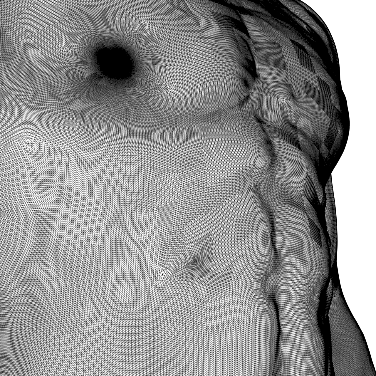

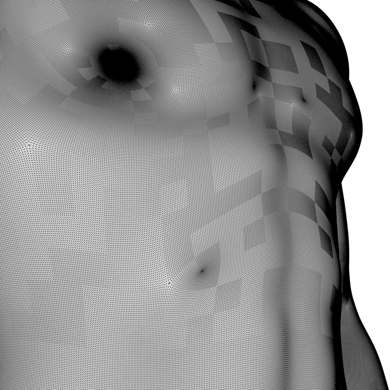

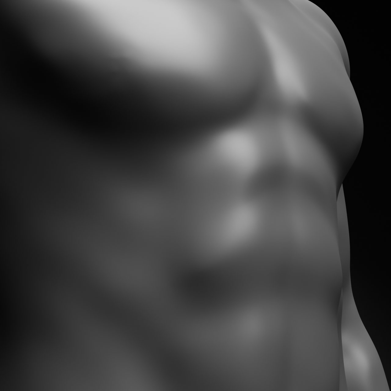

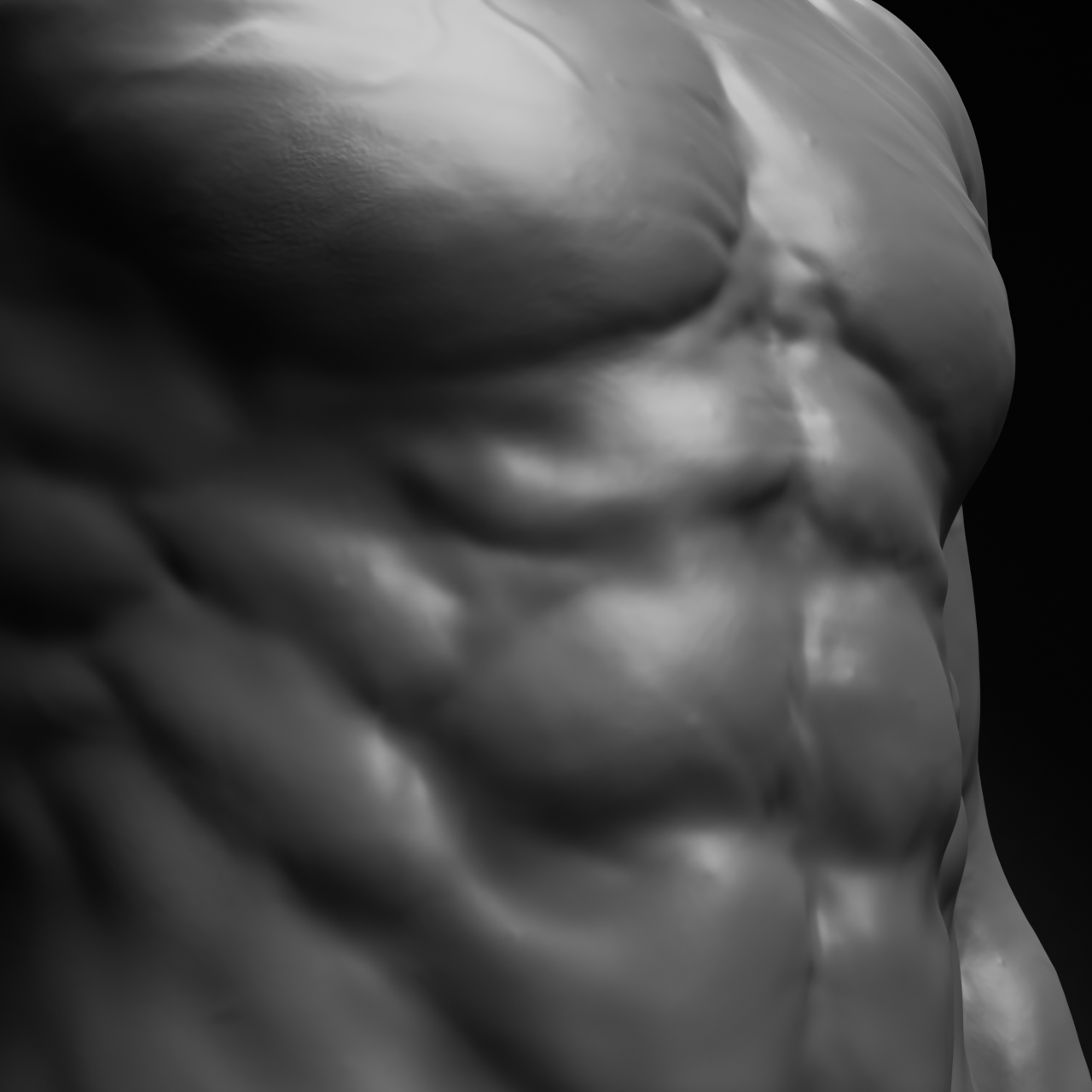

But yes, I also see the same issue as Sorel. Which makes sense based on the update notes - it seems that the "solution" was just to have Octane further subdivide the mesh to reach the same level of subdivision as the Render SubD value. But this will not add in the details from HD morphs. This is like exporting a mesh at low resolution from Daz and importing it into Blender and adding a Subdivision Surface modifier - yes it will smooth out the mesh but you won't get any extra detail. So unfortunately if we want to see HD morphs we still have to rely on cranking the viewport resolution way up, which is not ideal for performance.
In the below tests you can see that the mesh density is the same in the wireframe output, but the character has way more detail when the viewport resolution is set to 4, vs. just smoothing out the base resolution mesh in the first set.
Results with viewport resolution set to Base (no subdivision) and Render SubD Level set to 4:
Denoised beauty pass.
Wireframe render pass.
And here are the results with viewport resolution set to 4 levels of subdivision:

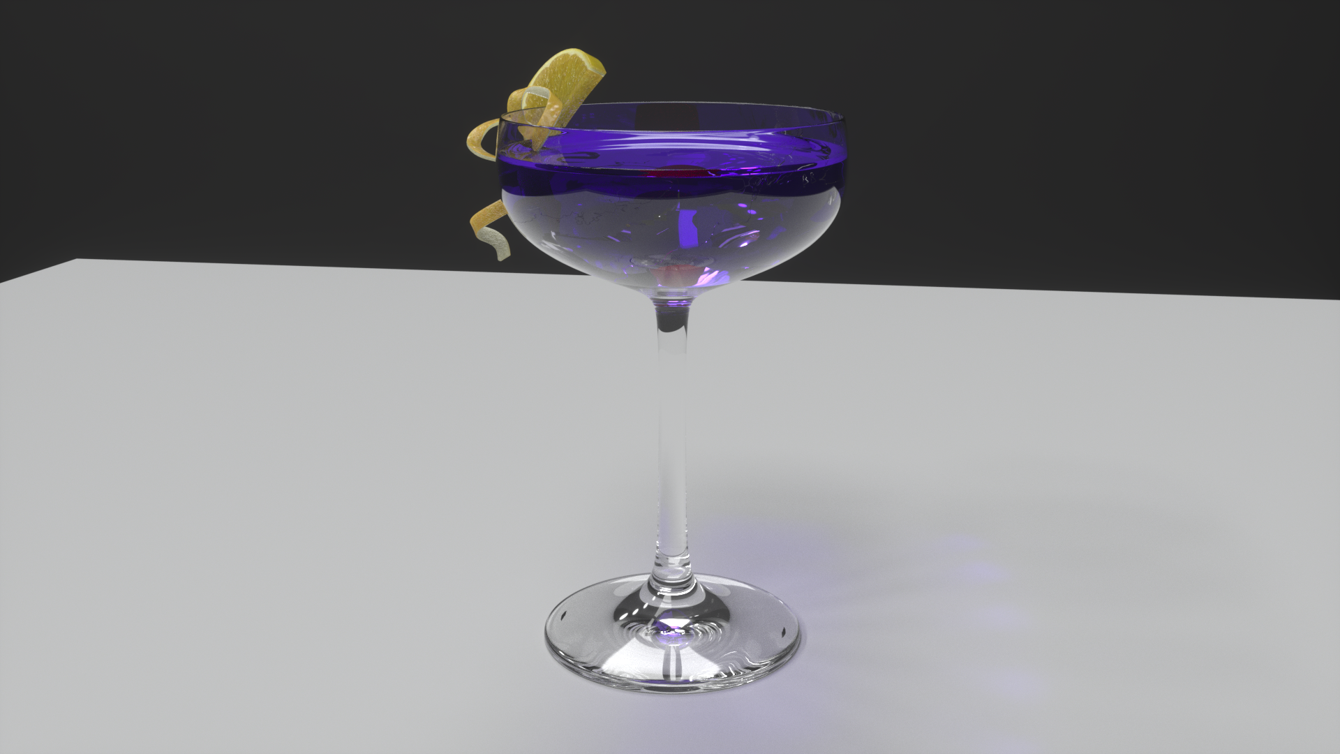

Sorry, not sure it is related to any version specific, but rendering a glass bottle etc just makes it invisible and quality on increasing the opacity is not quite good. Also liquids and gems have same issue.

delguy wrote:Sorry, not sure it is related to any version specific, but rendering a glass bottle etc just makes it invisible and quality on increasing the opacity is not quite good. Also liquids and gems have same issue.
I did a test, and those types of shaders seem to be fine on my end.
