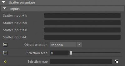

Here are my steps.
Create a sphere > enable "Scatter on Surface" via the octane rollout under the sphere shape:

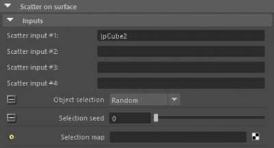

Create a small cube to use as a scatter object > Try to MMB drag this cube into the "scatter input #1:"

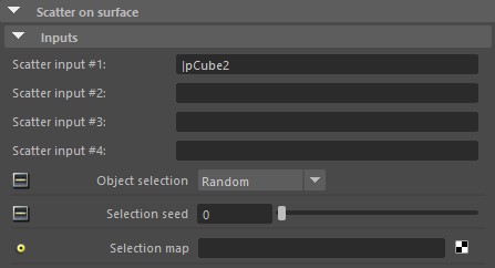

It then Shows the cube in the desired slot. But If I click away from the object and re-enable the selection it is gone. It seems like the issue stems from there being no obvious way to connect scatter objects to the scatter system.
Am I doing something wrong? or is this a bug? The workflow seems clunky.

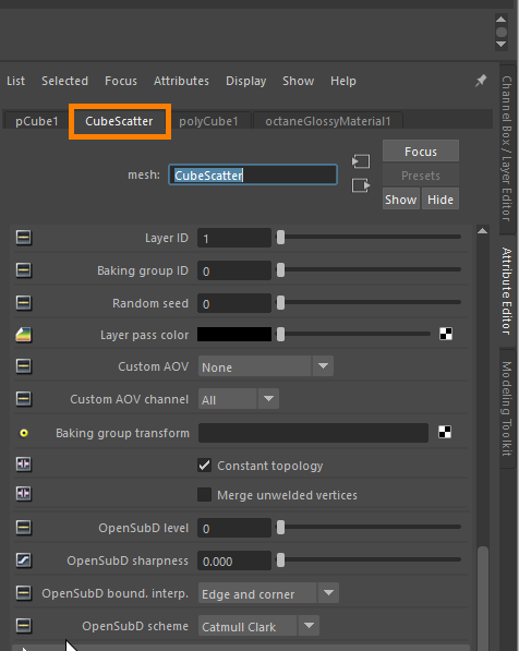

The only thing we see is that *Scatter input #1* is currently connected to Cube Transform. For this, we need the Shape node Mesh's name of the scatter mesh.
For example, Copy the name from here,

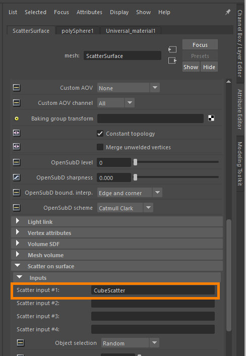

And paste in the Scatter input #1 of the Surface Mesh:
We recommend using the Maya node editor so we can connect to the pins.
Also, drag&drop from Node editor would work but not from the Outliner.
