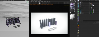

It seems like Octane is no longer getting instance id numbers directly from a cloner.
I grabbed the example file from https://docs.otoy.com/cinema4d/InstanceRange.html and put it into C4D s26/Octane 2021.1.5(R2). Attached is a screenshot showing that the instances with Octane Object Tags are still responding correctly, but the Cloner itself is no longer mapping to the gradient.
I'm using Win 10 with an RTX 3080.

I supposed I've ruined something and checked. But it's working! Did you use render instances?
Oh, no - didn't try render instances, since in the help file it doesn't say that you need to do that. Neither the screenshots in the help nor the test file is set up like that, so I'm assuming it worked with normal instances in previous versions.I supposed I've ruined something and checked. But it's working! Did you use render instances?
Render instances are extremely limited in what you can do with them (no deformation, can't offset animation, doesn't work with Subdivision Surfaces, etc etc), so I always avoid them.
Any way you make it work with regular instances in a cloner?

It should be changed to fix something else in a previous version. You can activate ID generation by adding some effector with using the color parameter. Also you can use Instance Color for different usage.
