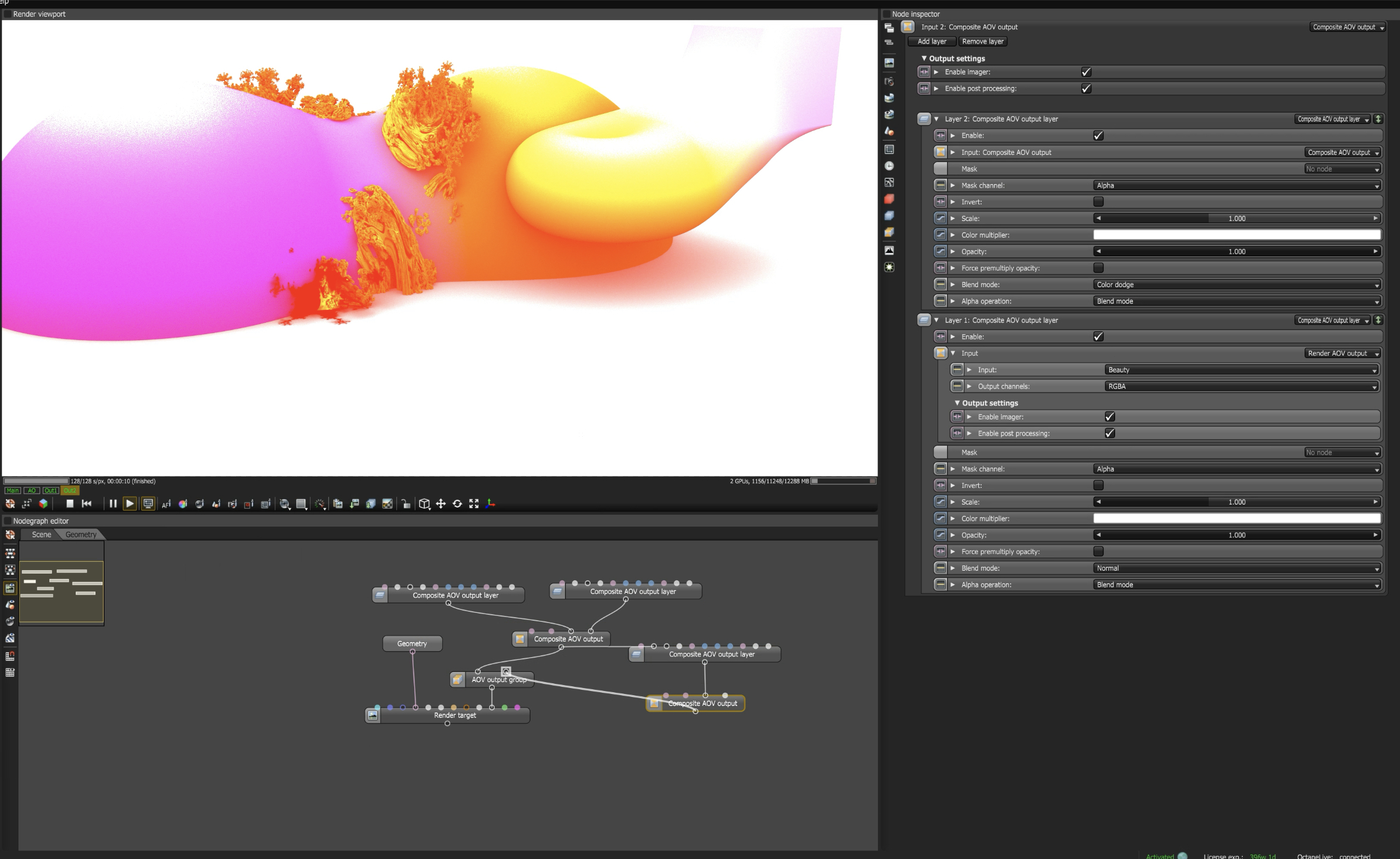

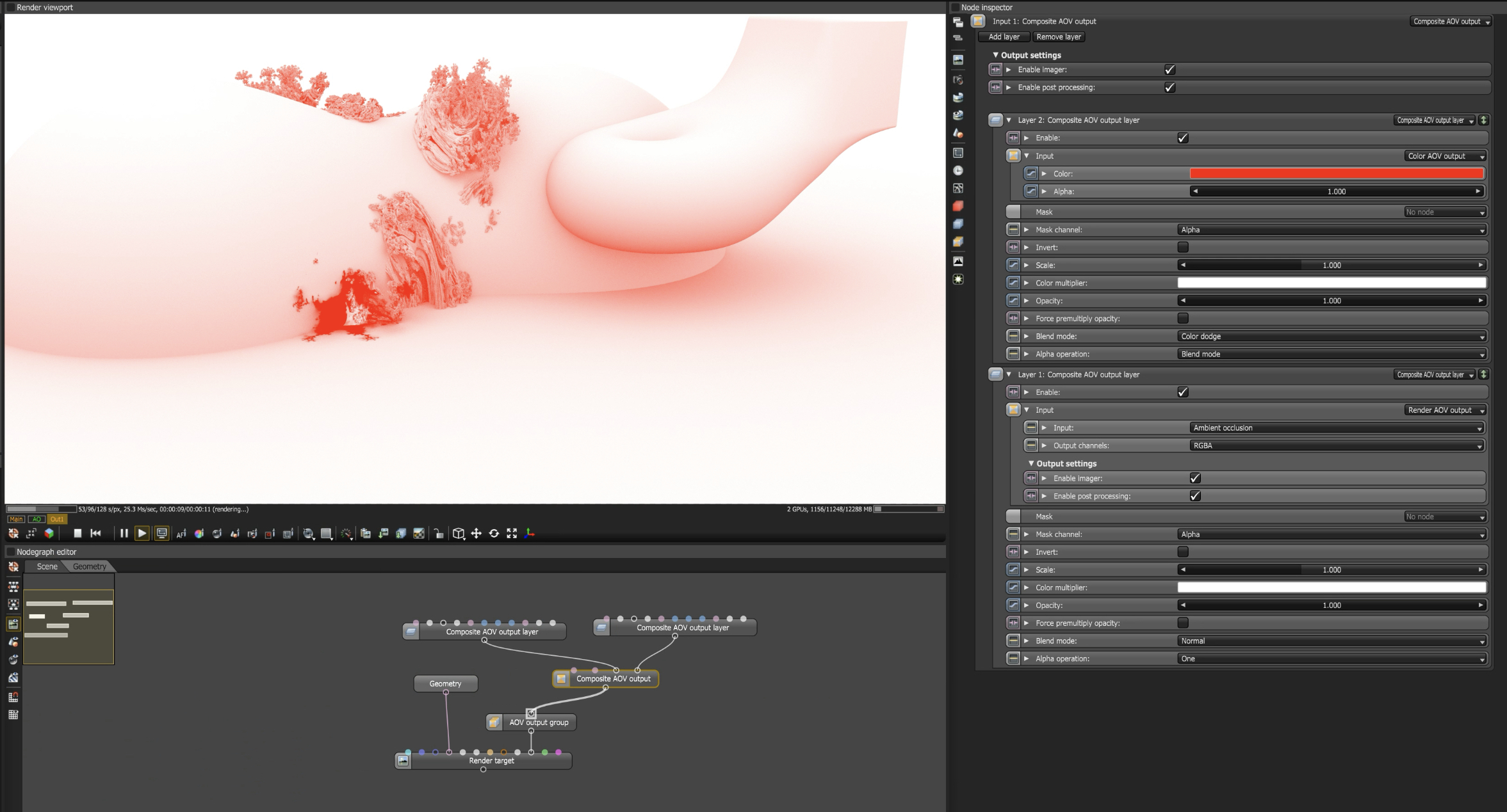

Nope, but you can use a Composite AOV group to add a Color AOV over the Ambient Occlusion pass:
Then use the output to mix it in another Composite AOV group:
ciao,
Beppe
