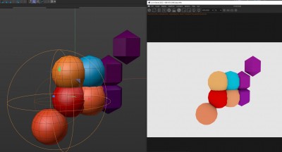

ok, here is the link to simple test scene with morphing objects and change their colors using mograph and fields:
https://www.dropbox.com/s/fkjunodo1d3xl ... t.c4d?dl=0
I investigated that scene rendering wrong in all 2021.1.4 and newest 2021.1.5 builds.
But 2021.1.3 and experimental version 2022.1-XB0_R1 working good.
That's mean all present versions for R26 working with bugs.

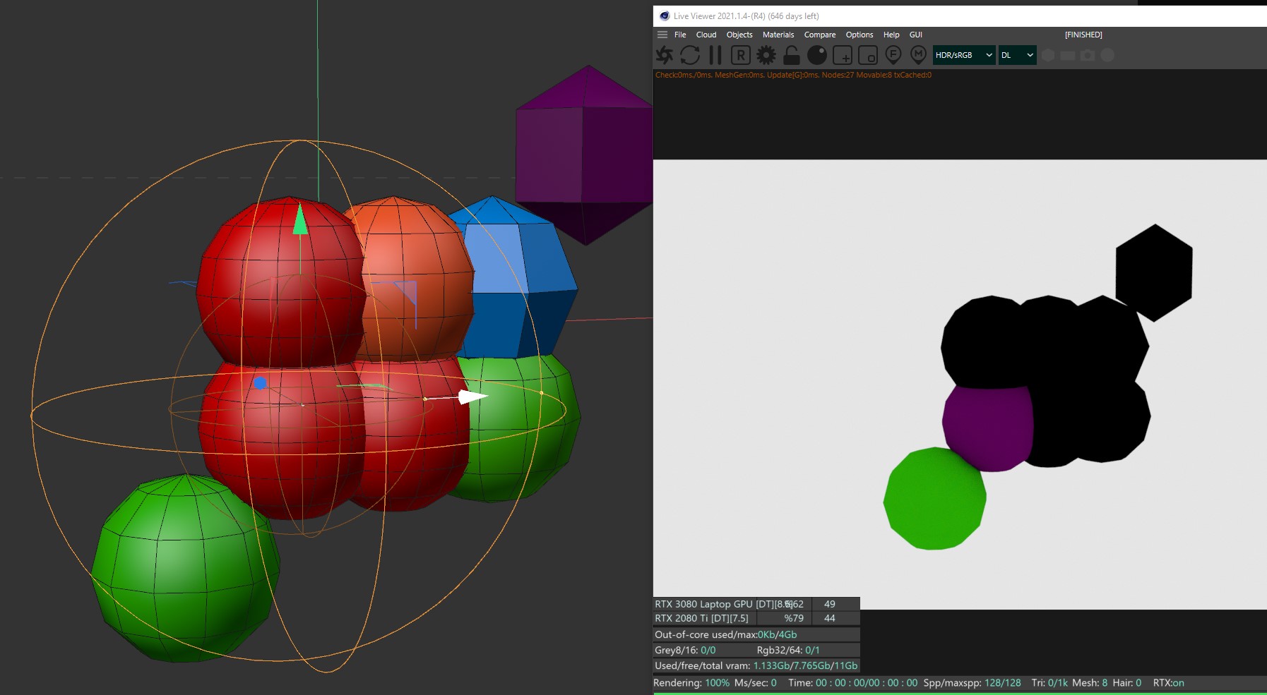

I recorded video how it's working on my machine:
https://www.dropbox.com/s/fscqd3sr0v5ax ... 6.mp4?dl=0
for sure I've try applied material on parent cloner, but it doesn't help(

Yes you're right! It doesn't correctly work in case. I'm trying to bring better mechanism to calculate it well.

New Octane version for C4d 2021.1.5-R2 still works incorrect((
