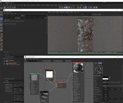

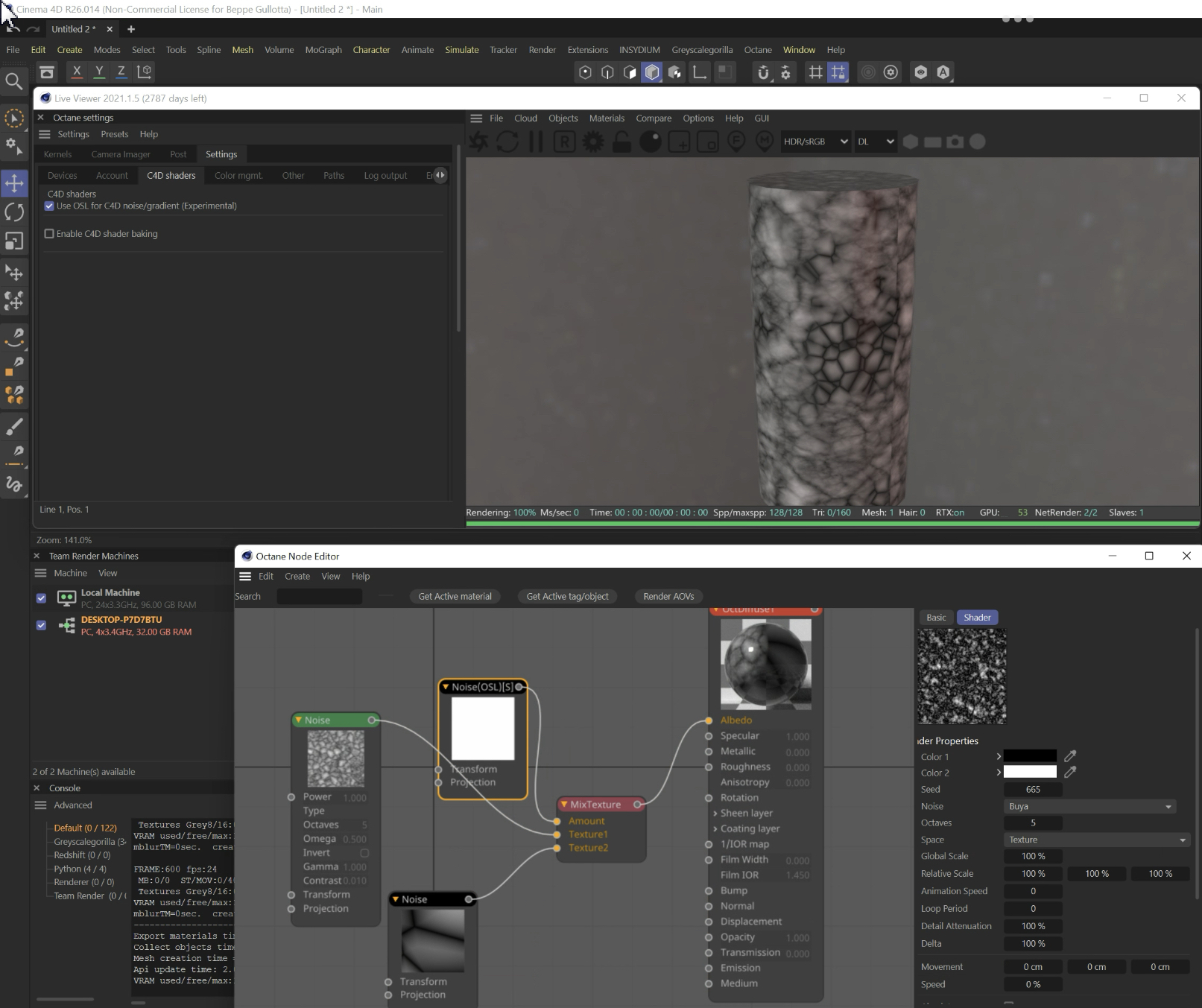

I`m trying to recreate a terrazzo style material which uses 2 c4d noises which are than mixed together wit the octane noise node. As soon as I add the octane noise the material splits in green and blue. No matter what kind of object it is. Do you guys have any idea what the problem could be? I attached some screenshotsImage

Please go to c4doctane settings/C4D Shaders, try to keep active only the OSL option and report back, thanks.

Hey Beppe,
thank you for your reply. The OSL option was/is checked.
The c4d shader baking option also brings no difference.
Could this be an octane problem or is it a c4d problem?
