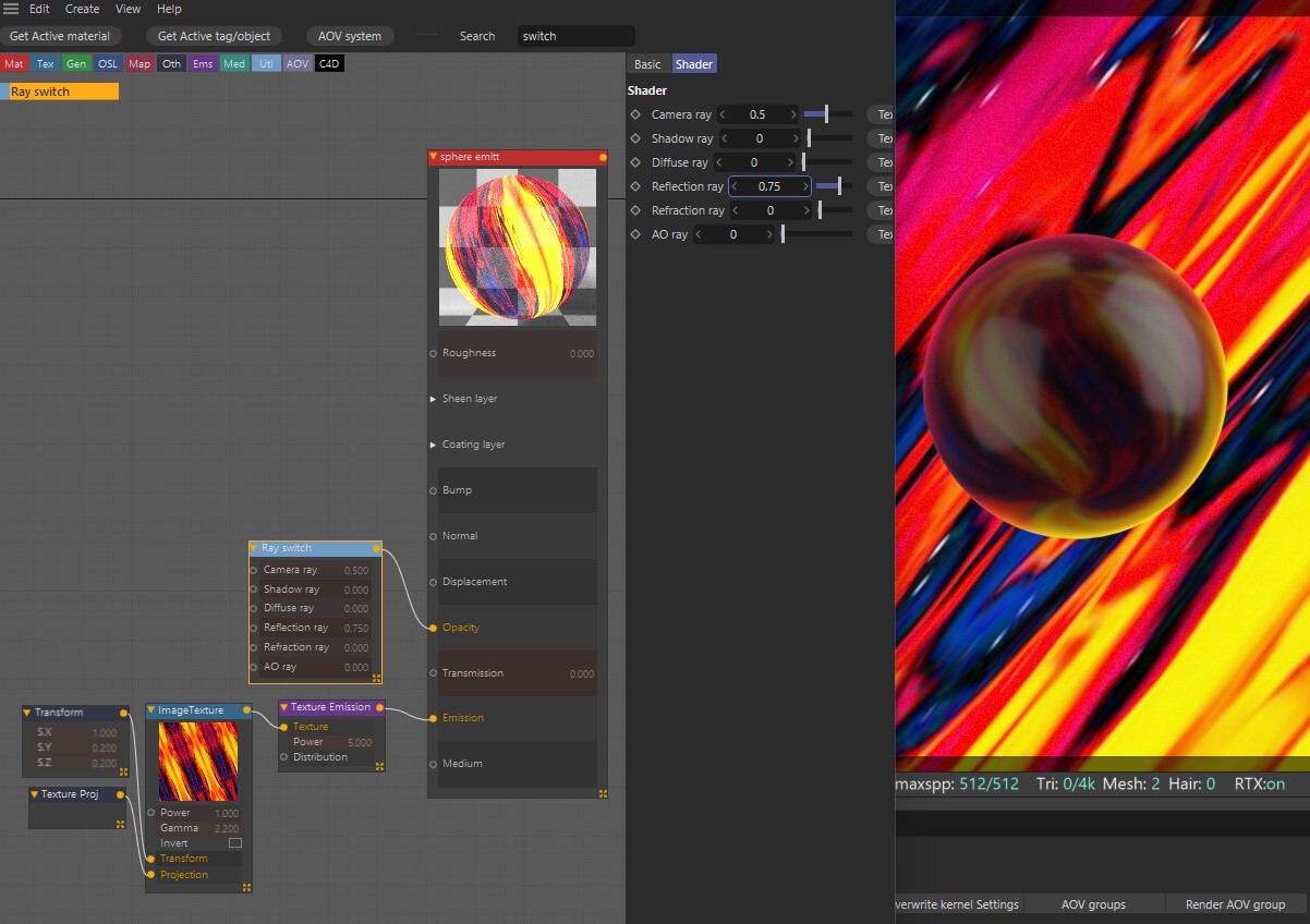

maybe you can try with the "Rayswitch" node, playing with the values, and also the power of your emissions to get the desired result.

It is working a bit indeed, that is a nice tip to know thank you!
But I can't imagine that it is not possible to put invisibility to an dome sphere while retaining its emission.
Like it would be cool to have light linking for HDRi as well. E1, E2, E3 for example.
Anyway I was on a deadline so I ended up not using an HDRi but just area lights for my scene lights. Keeping the HDRi for just my specular reflection and exclude the environment for all other objects in my scene.
