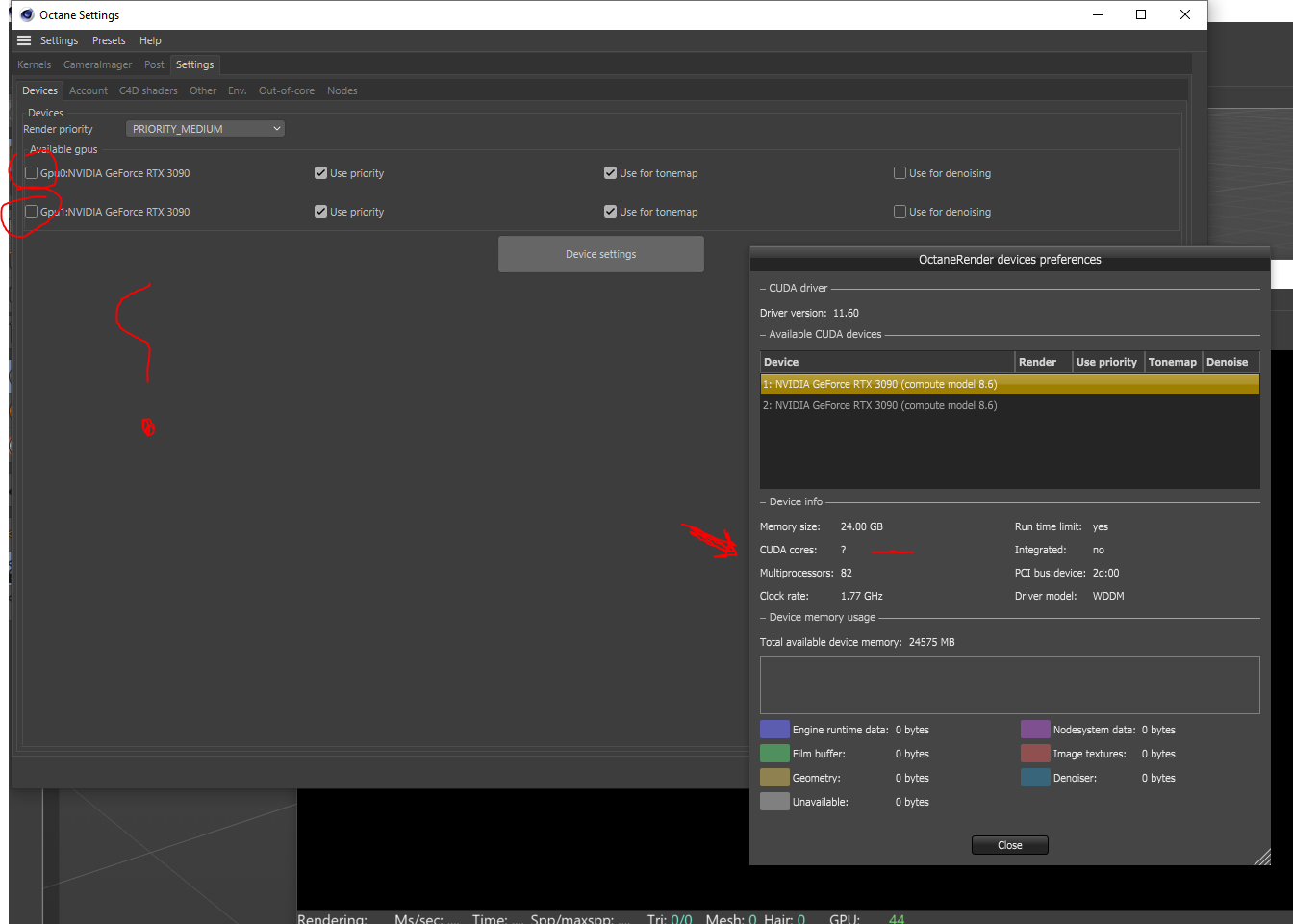

Hi
i have Problem with this message appearing when opening
"There is No CUDA device which is selected"
Also, I would like to ask, is the old license support RTX3090 x2
___________________________________
OctaneRender-for-C4D-V4.05-R7
C4D R21.207
CUDA Version : cuda_11.6.2_511.65_windows
NVIDIA STUDIO : 512.59-desktop-win10-win11-64bit
2x RTX3090 MSI
CPU x5950
Posts: 10590
please have a look at here:
viewtopic.php?f=30&t=79148&p=408867&hil ... v4#p408867
In short, you need to purchase an Annual Extension for 199€, to be able to run any recent OctaneRender version:
https://render.otoy.com/shop/upgrade.ph ... C67-UGAA1Y
ciao,
Beppe
ahmedadel21
Posts: 3
Joined: Thu Jun 02, 2016 11:38 am
Thanks you Beppe
Everything is good now .update have great features ;)
