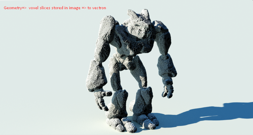

Soooooo, I got a little carried away but I managed to get something kinda working. Learend a lot about SDF's and Vectron.
I figured, you can't import geometry in a vectron shader but you can import images so I made a setup in Houdini that writes out voxel slices to an image and then wrote a vectron shader to read in the right slices. Kinda cool ! Now , of course, I'd like to somehow "mesh" the voxel grid or smooth it somehow, not sure how to do that...

I'd love to know what you're up to with this workflow - it's really interesting! What are the benefits to you in rendering Vectron versions of geometry ? is there a reference image you can share or ideas of what interesting outcomes can come from this ? i'm keen to know : )
Well, the idea of no geometry and doing infinite resolution surface detail on the gpu was what drew me to Vectron. After experimenting with it and understanding it a bit more, I came to the conclusion that's it's not really suited for what I had in mind. When you get to the point of having surface detail comparable to a mesh +displacement workflow, it quickly becomes very slow not to mention it requires a lot of extra steps and effort. For now, I think Vectron is best used for what you've probably seen already, rendering of fractals / math formulas.
