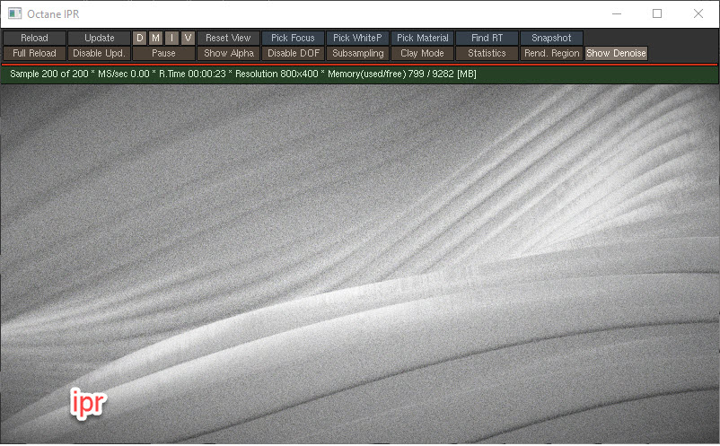

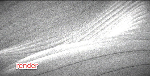

Hi
My Ipr looks like this and I want to have it on AE:
But rendered image opens like hell:
please help!

its ignoring highlight compression ,
modjtaba
Posts: 58
Joined: Thu Sep 21, 2017 4:29 pm
Seems I found my answer in AE, Highlight compression has an equivalent there for HDRs.
