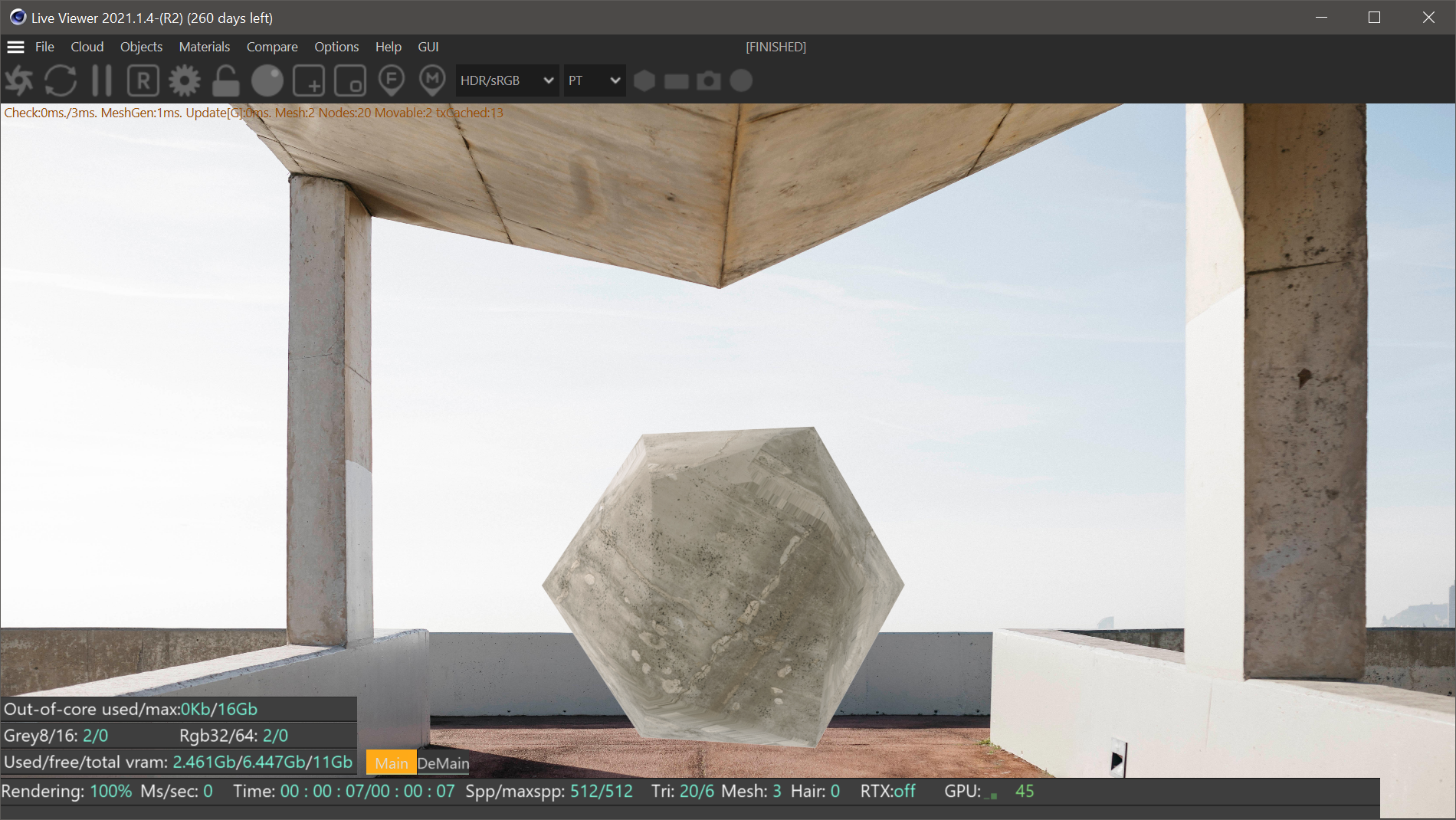

I had to merge your file into a new scene, as it seems there were some issues. Here is my result:
And the scene file:
background_crash-jr.rar
(124.59 KiB) Downloaded 81 times
Some notes:
  • Never use the bitmap node — always use the Image Texture node instead. The OctaneSky object was using the Bitmap node.
    You had Alpha Channel disabled in the Render Kernel. If you use the Background Object, you need to enable the Alpha Channel in the Render Kernel in order to see the result.
Hope this helps!
