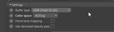

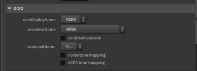

I am coming from c4d octane and still a bit lost in Houdini and I dont know where I put what.

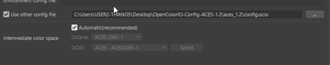

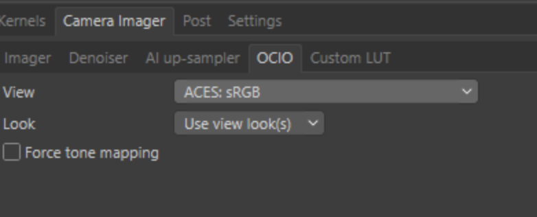

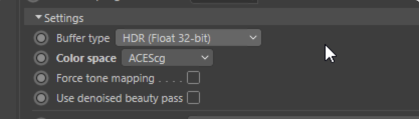

How do I setup aces please? Attaching a few images to see what I am after.
Many thanks!
This is export
This is export
This is for ipr
This is for ipr

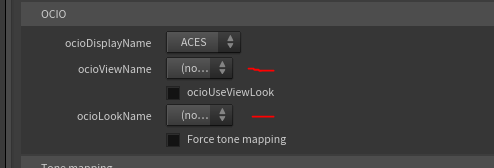

Pointing to ocio in my drive

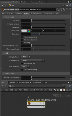

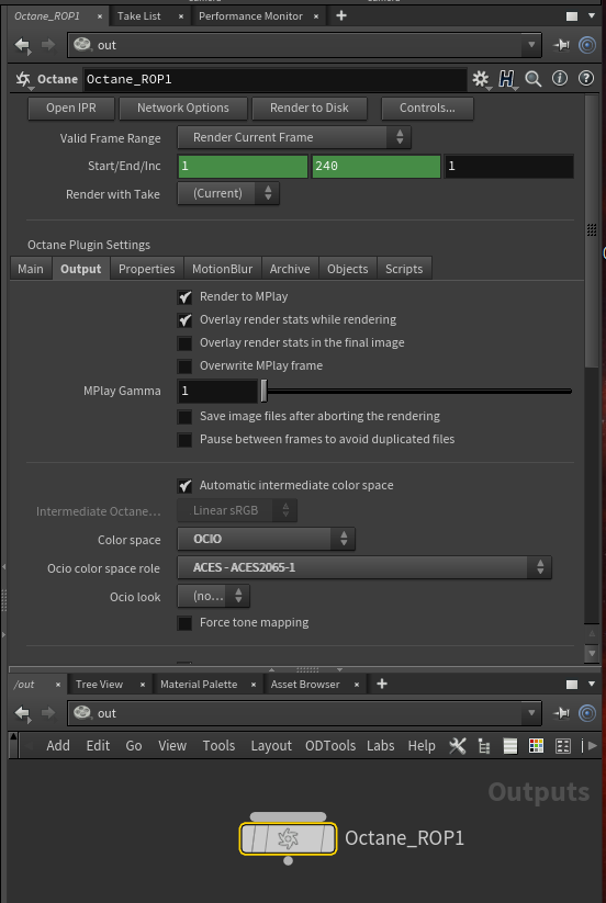

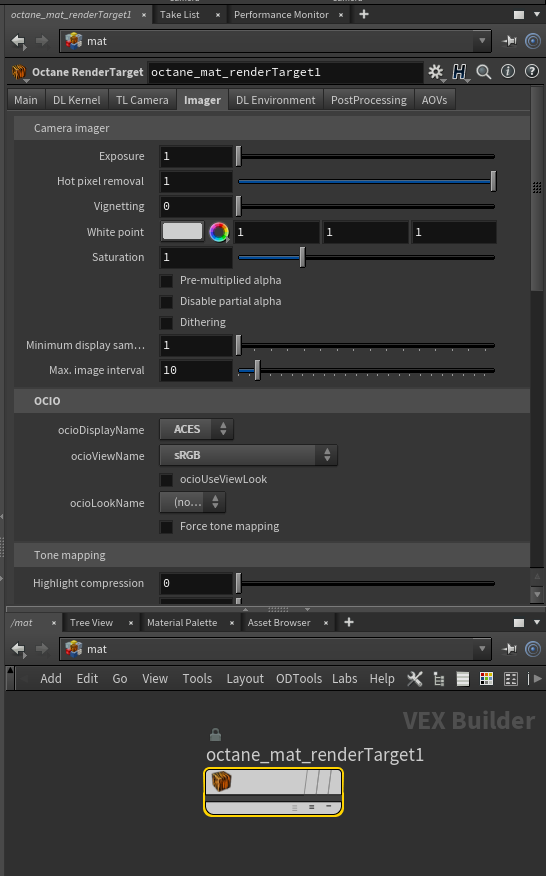

In Houdini, please follow these steps:
1) You need to configure the OCIO environment variable pointing to your OCIO config file
2) The scene level OCIO options are available in the Octane ROP node, Output tab.
3) The IPR level options are available in the RenderTarget /mat HDA, in the Imager tab. Be aware that you need to select the ocio display name "ACES" even if it is the default option to let the HDA populate the views drop-down menu.
Hope it helps,
-Juanjo

hi
My ocioViewName have no choice,how to set?

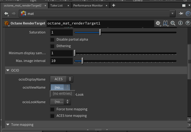

juanjgon
Posts: 8867
Location: Spain
jamnique wrote:I'm having the same problem as @yujunjoe.
Tried in houdini.env, as well as setting as system variables (Windows 10) / both at the same time. Nothing works.
Please, select the "ACES" (or other) ocioDisplayName. Even if your display name is selected by default, you need to select it to let the HDA populate the ocioViewName drop-down menu list. I'm still thinking about how to solve this issue.
Thanks,
-Juanjo

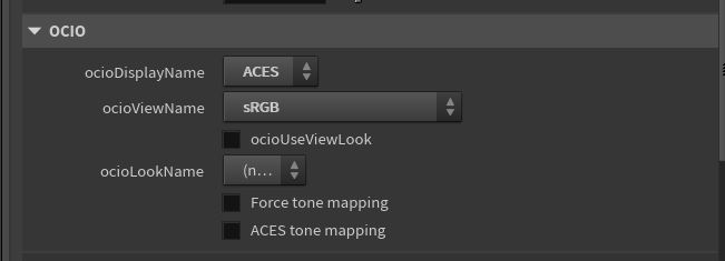

jamnique
Posts: 227
Joined: Tue Jan 12, 2010 9:47 am
Location: Warsaw, Poland
So that's what I've been missing! Thank you, it works :) Additional question: I noticed in your screen you have "ACES Tonemapping". I don't have it in 2021.1.5. Does it come in newer builds or am I missing something again?
Intel Core2Quad 9200 / 4 GB OCZ / Gainward 460 2GB
juanjgon
Posts: 8867
Location: Spain
jamnique wrote:So that's what I've been missing! Thank you, it works :) Additional question: I noticed in your screen you have "ACES Tonemapping". I don't have it in 2021.1.5. Does it come in newer builds or am I missing something again?
This is an Octane 2022.1 feature.
