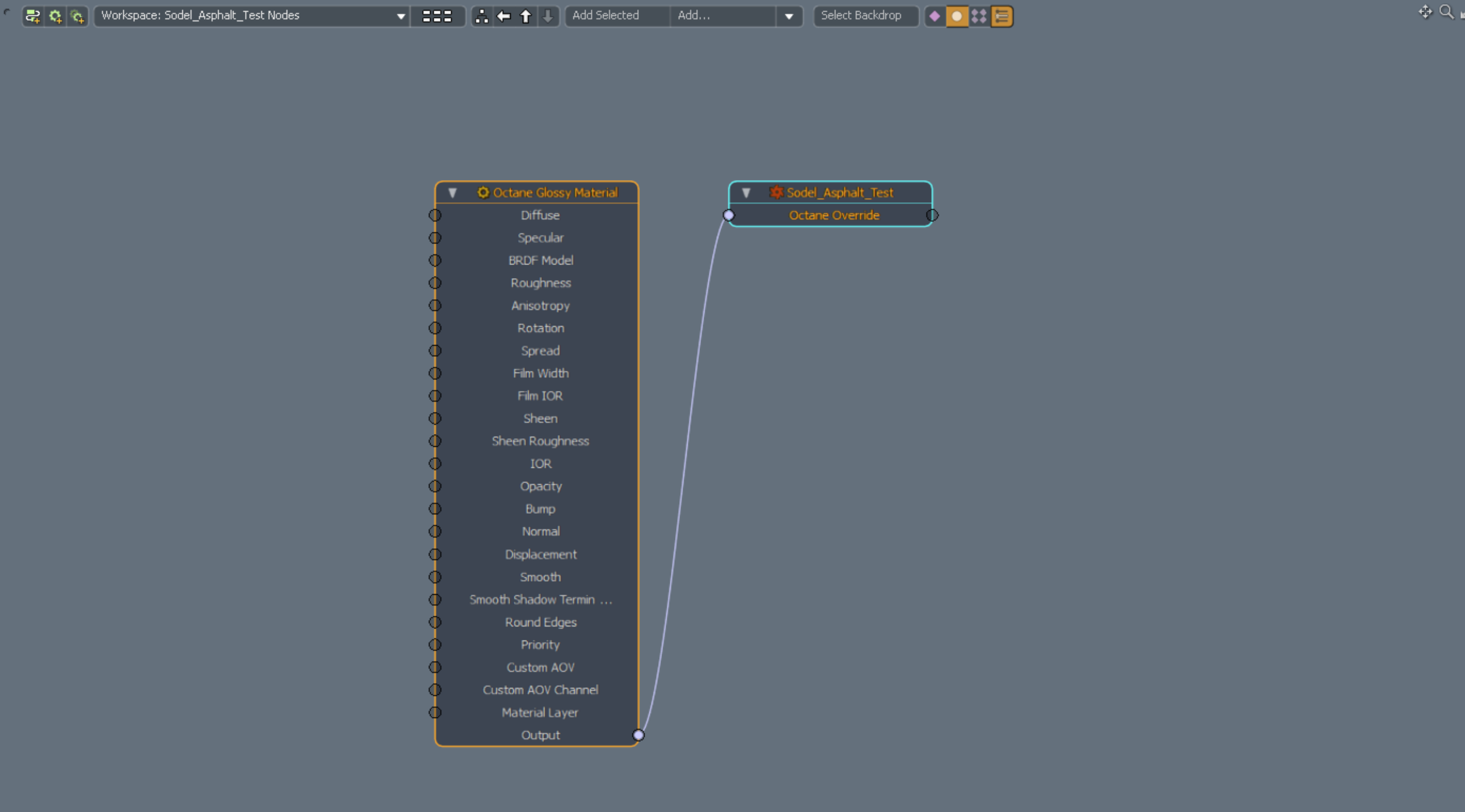

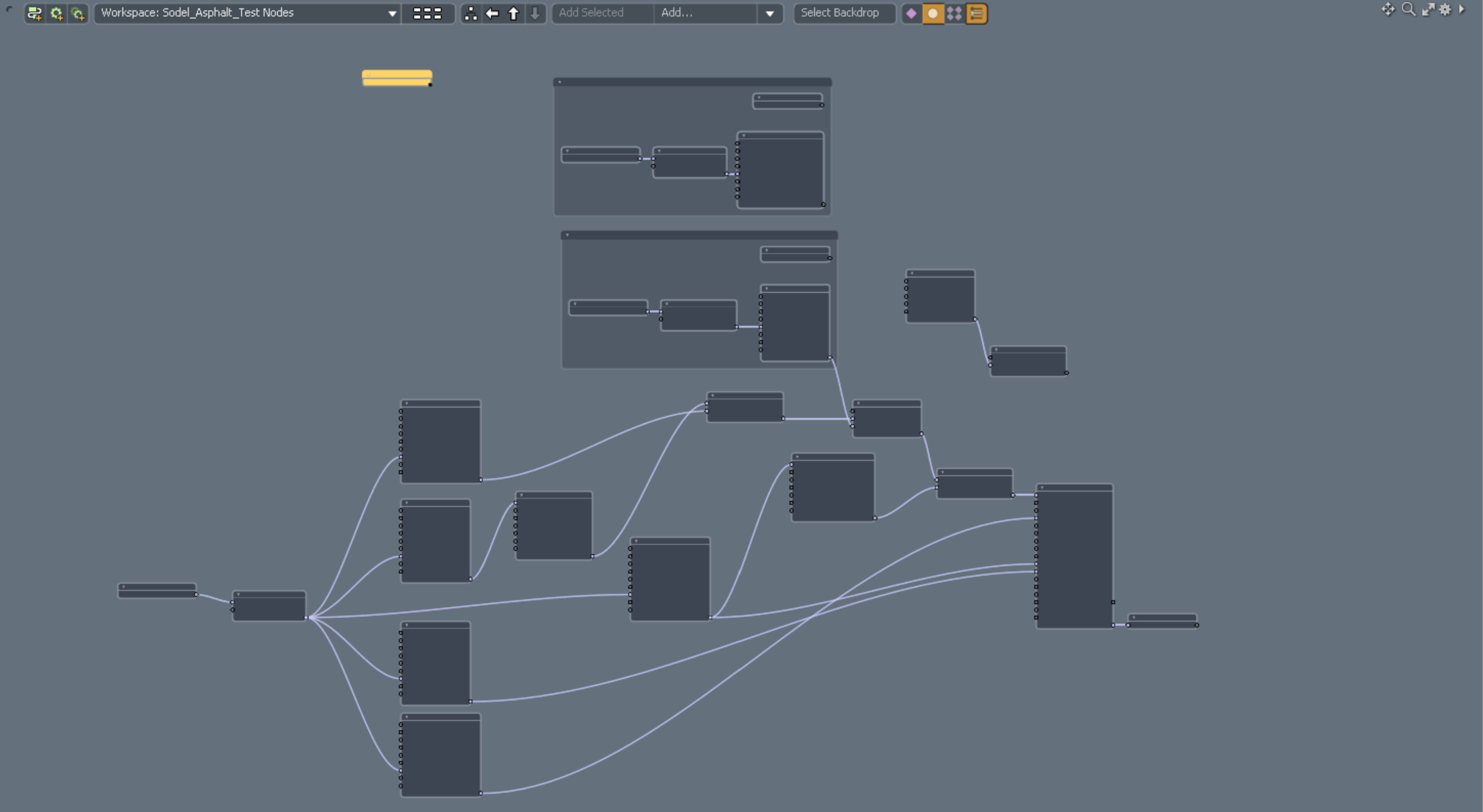

Having an issue exporting and importing materials with the Octane Modo plugin and I'm dead in the water.

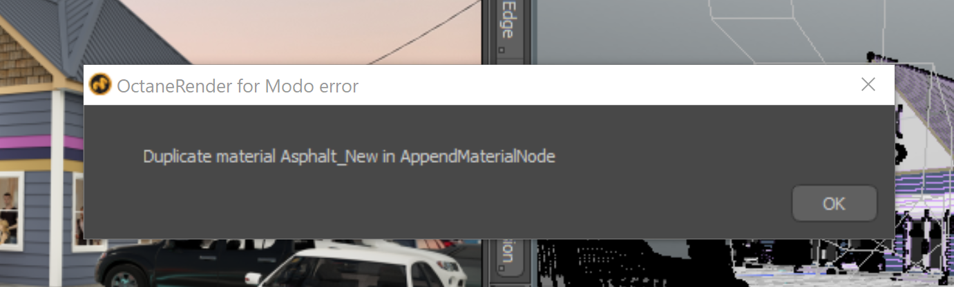

I will create a material with an octane override, select said octane override in the shader tree, type "octane.exportmaterial", choose a name and and save as an .orbx or .ocs file in my local db folder (I have been trying both .orbx and .ocs because neither seem to work). Sometimes I get this error message about a duplicate (Attached) which is odd because it is a new file I am saving for the first time. Sometimes it will save a ~10K kb file size and sometimes it will save only a ~ 4 kb sized file. Furthermore, when I import the file using either "octane.importlocaldb" or "octane.importLiveDb", I get an empty file with the ~4,5 kb size file or a node with just a single attribute-less material node (e.g. "Glossy Material") plugged into the override with the ~10K kb sized file (attached). Sometimes that imported override will change names from what was saved to something else, for example, if the override was saved as "custom_asphalt" it will reimport as something random like "Gray Scale Image" or "Transport Value".
Another thing, the same file with the lone material node will actually open and render properly in Standalone but not Modo.
Any ideas?
