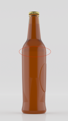

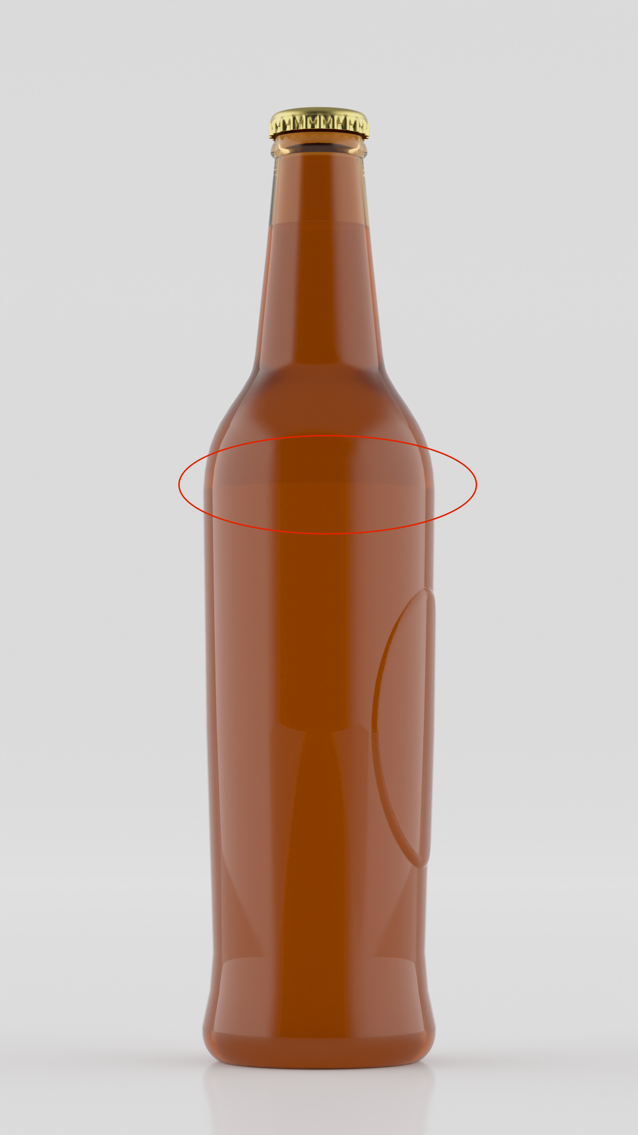

Hello,
I use Octane in Cinema 4d and have a problem with the displacement. I want to create an embossing through the displacement of a glass bottle. At the top of the bottle, where the texture of the displacement ends, a line is created. Unfortunately I have no idea how to get rid of this line, does anyone have a tip? Thank you
Dennis

Thank you for your answer. I just tried Vertex Diplacement, but it didn't make any difference. I have to say, however, that the mesh of the bottle is relatively roughly divided, as I built the bottle with a lathe.
Dennis

Make your displacement map the entire length of the bottle.
