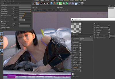

I want to achieve a plastic fabric effect like this.

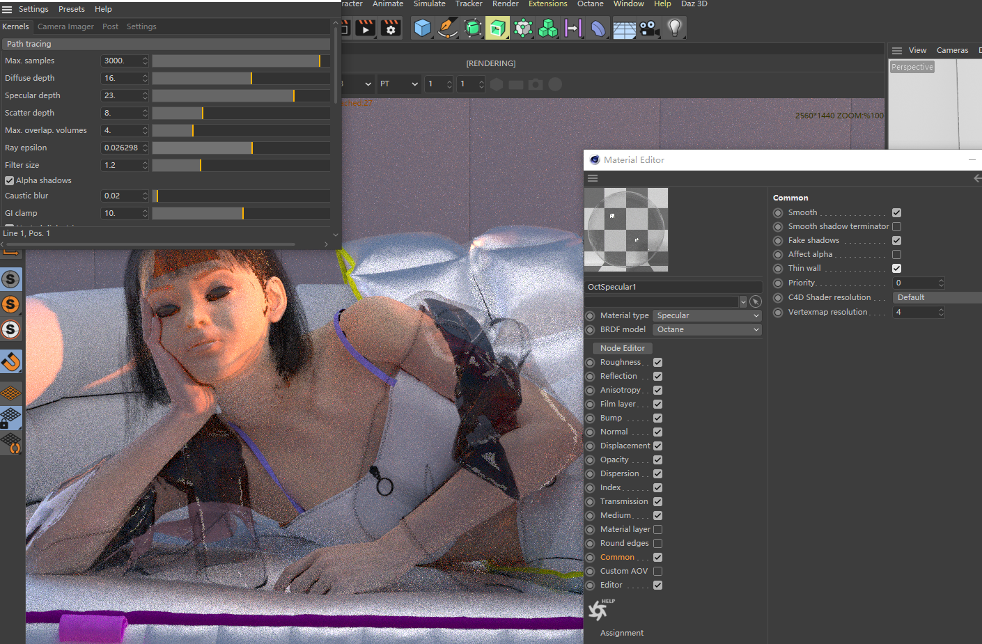

but when adding thickness to the fabric, it turns out black and does not show anything behind the fabric.

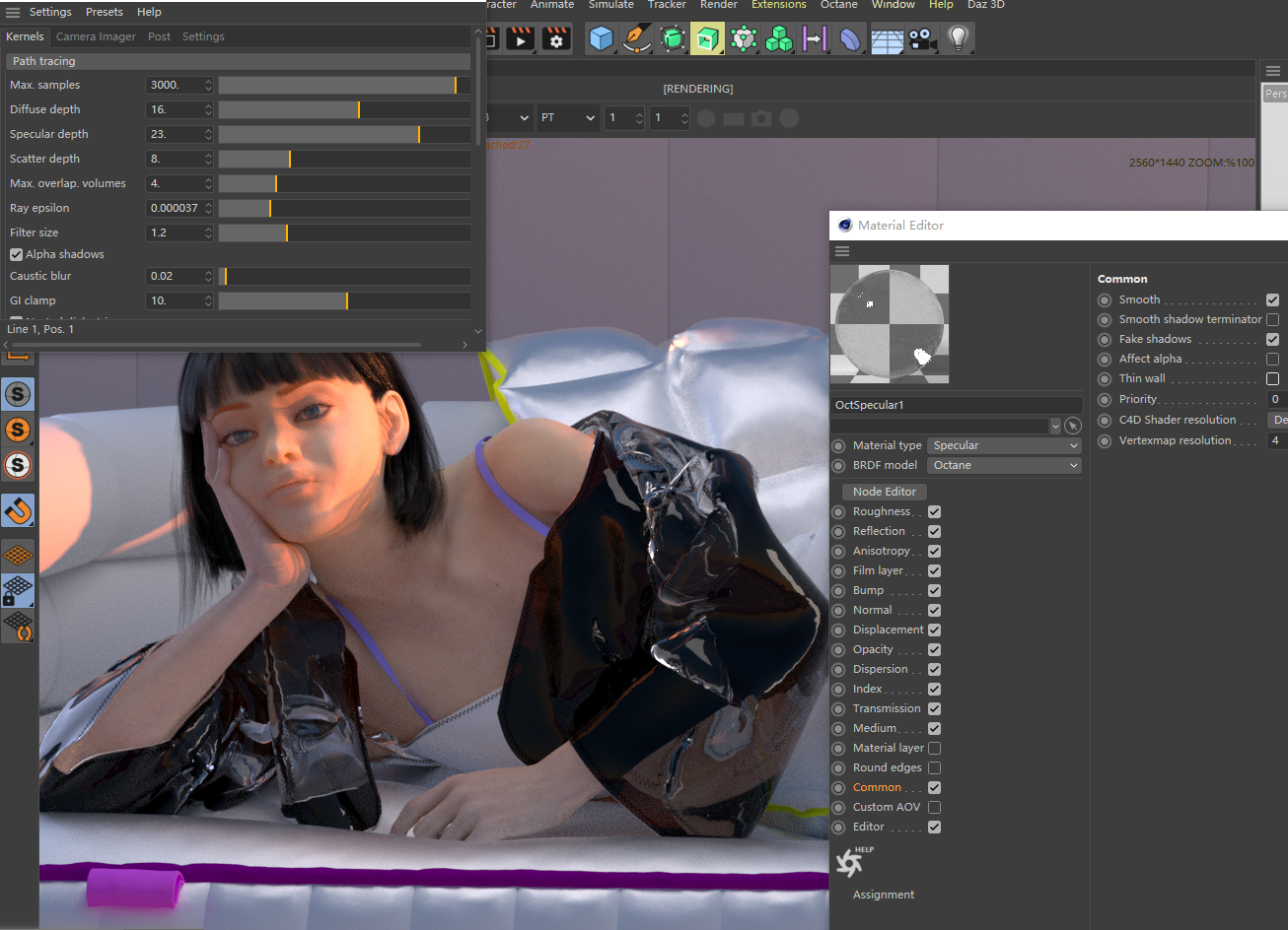

If I change Ray epsilon part of the black on fabric will go but the girl`s face will be a mess.

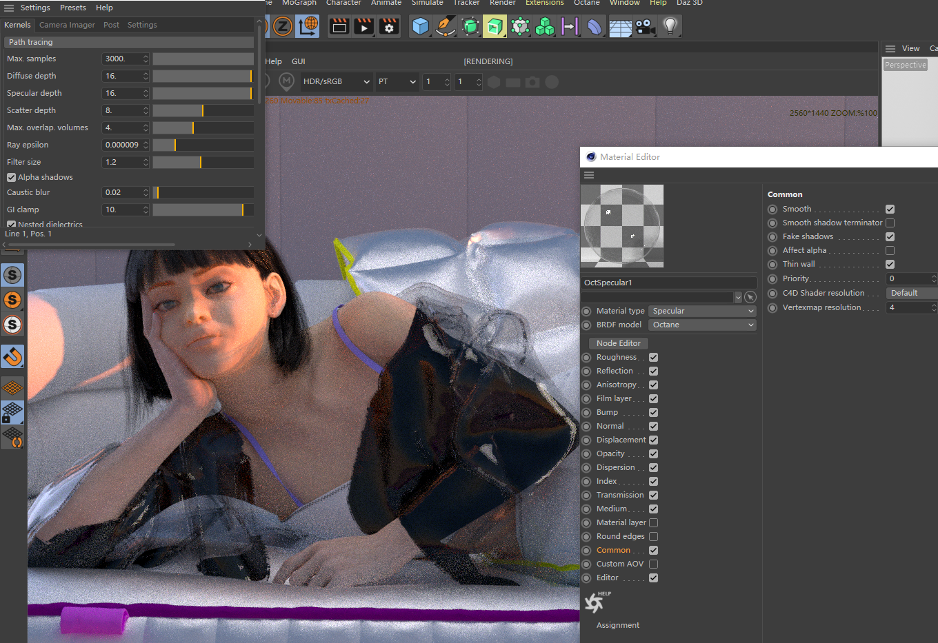

IF I unclick thin wall and it will turn into a totally black
How do I solve the problem? :cry:

Problem solved! Reverse normal!
