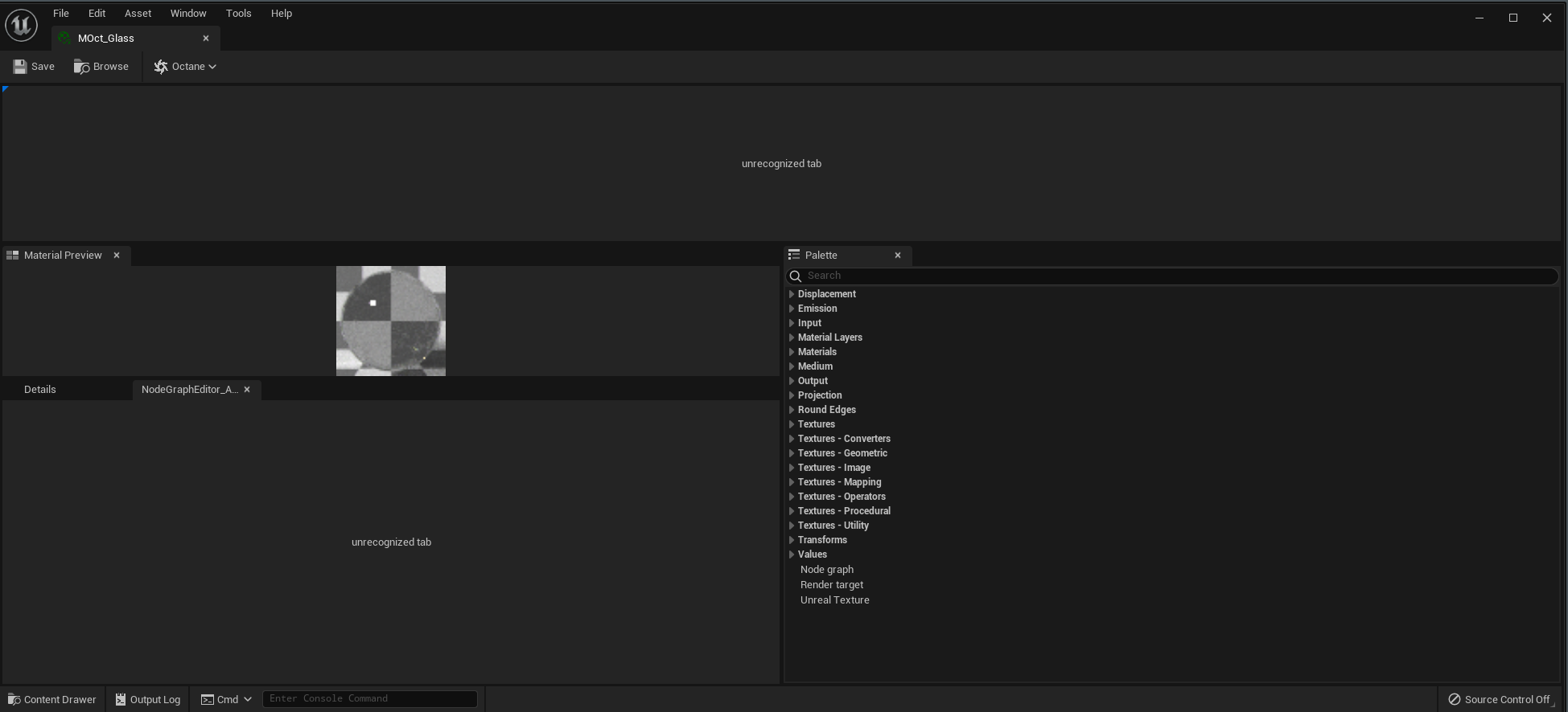

I'm using it inside UE 5.0 right now and I've got a question: I'm trying to create an Octane material, but when double-clicking on it to open up the editor, all I get is the window below:
It looks like the node editor is gone. Any idea what's not working here? Thanks for letting me know :)

Thanks for pointing this out. I replicated the issue by resetting the unreal layout, and working on a fix.

Thanks Chris. Does that mean that resetting the UE layout fixes this, or that you'll have to provide a fix, before I can get this to work? Thanks for letting me know.

Ferdinand13 wrote:Thanks Chris. Does that mean that resetting the UE layout fixes this, or that you'll have to provide a fix, before I can get this to work? Thanks for letting me know.
I will need to make a new build with the fix.
Sorry, with that comment I ment that for some reason it appears that the bug does not happen when unreal editor stored the UI layout from a previous version of unreal (most likely 5.0 Early access).
So resetting the unreal layout made the bug happen on my machine.
