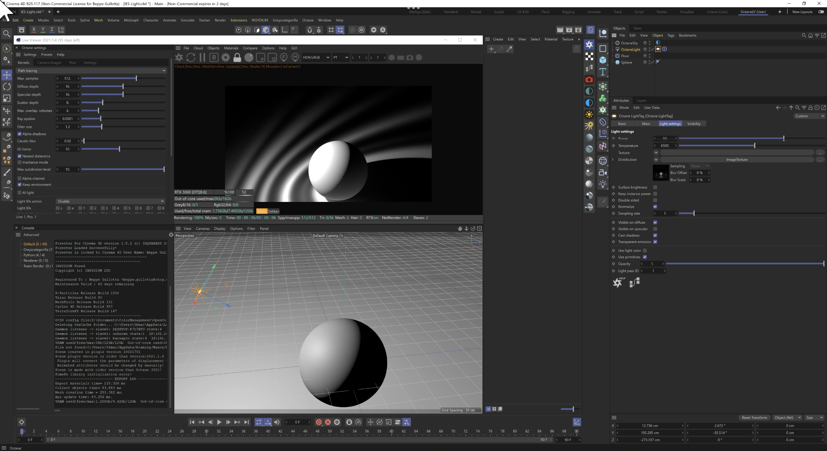

Posts: 10563
everything seems to work as expected here with 2021.1.4:
IES-Light.zip
(103.96 KiB) Downloaded 82 times

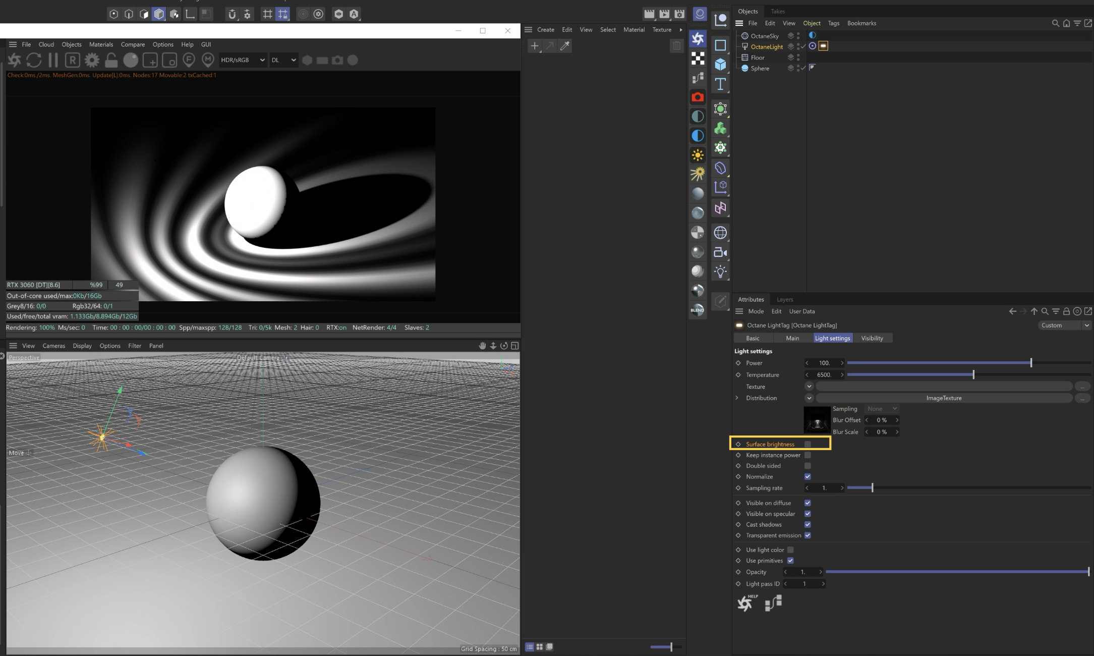

Posts: 10563
Ok, now I see where is the issue.
Please disable the Surface Brightness option in the IES Light tag:
ciao,
