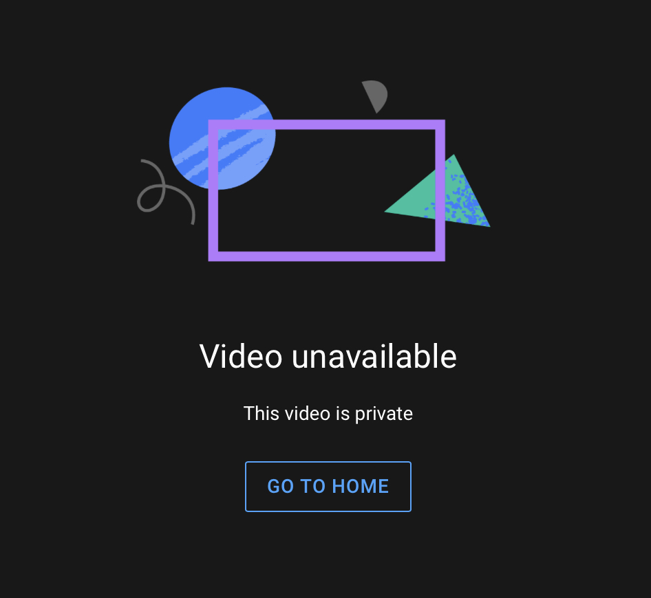

unfortunately the video is not available, I have this error message:

Hi and thanks for your reply, now the video should work - it shows that when PV is active the frame takes 2 seconds, when inactive, it takes 11 sec. I'm using one GPU and 3 monitors. But it slows down exactly when I click away and gets faster at the same time I click on the Picture Viewer. It doesn't take time to slow down or get faster. Chrome is open, nothing else. I'm running an NVIDIA inspector while doing this and the strange thing is that the GPU load is consistently 99%. Also, I've tried an older version of Octane, so I still don't think it's Octane itself.

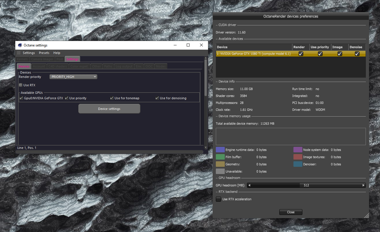

Please, go to c4doctane Settings/Devices panel, press the Device Settings button, and share a complete screenshot of both panels, thanks.

Hi Beppe, these are my settings:
Posts: 10480
Ok, please try to set the Priority popup to LOW, since HIGH means no priority, and report back, thanks.
