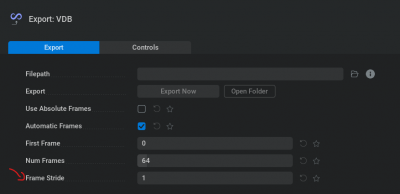

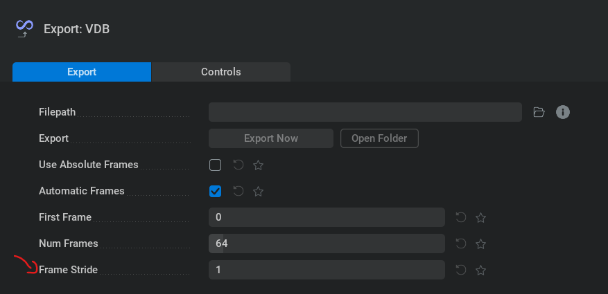

I have tried changing step values in Embergen so it is only rendering every third frame, but the result is choppy. Even changed the 60HZ to 24. Nothing helps.
So what I have done is render out 2.5 times the numbers of frames I need in EMGenFX, and tried to force the Octane vdb loader to use all 1000 frames, hoping it would run faster in a 400 frame sequence. But the Octane VDB loader only uses a 1:1 frame number. In other words, it's only using the first 400, not the full 1000. So it still runs slowly.

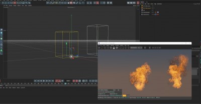

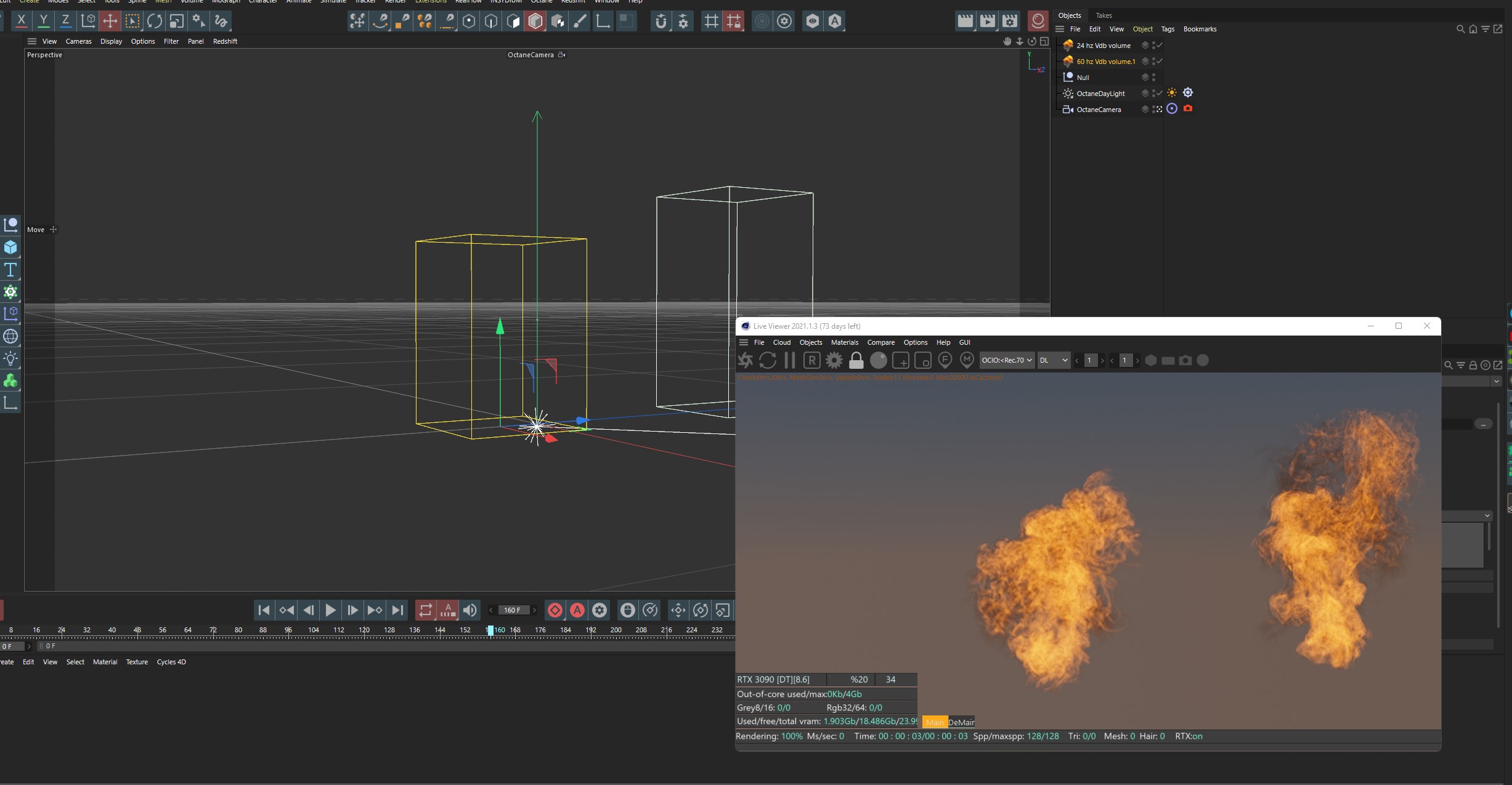

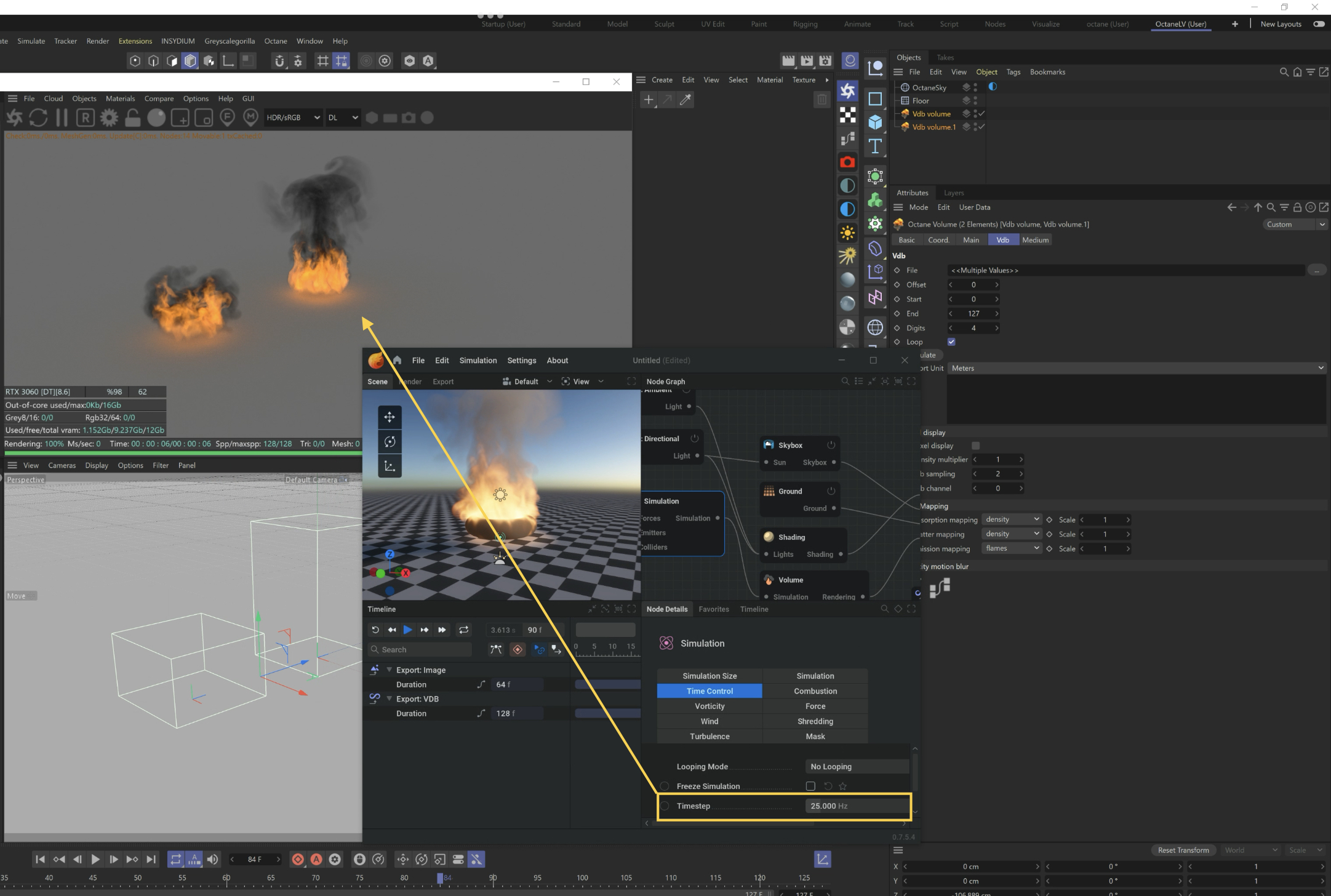

you can reduce the Timestep in EmberGen to export a faster sequence: The sim on the left is at 60h, the sim on the right at 25h.

Anyhow, I tried it again this morning. Yes, changing from 60HZ to 24HZ definitely speeds up the animation in the EmberGenFX viewer, and it may affect flipbooks, but it doesn't change the speed of the fire in rendered vdbs. At least not for me.
After creating the vdbs in EmberGenFX at 24HZ, I render in C4D (24fps project) and then take the rendered frames into AE and the fire is still playing in slowmotion. About 2.5 times slower. Changing the HZ speed doesn't affect the speed except on screen in EmberGenFX.
