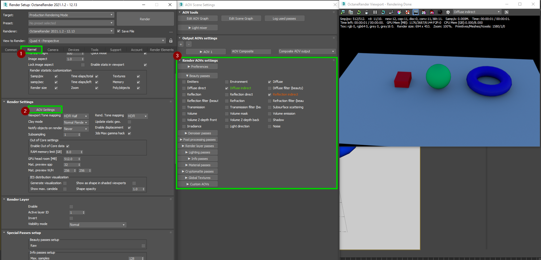

Hi HHbomb,
Thanking BK, Just wanted to add the Octane AOV workflow to render the passes/AOVs using OctaneRender for Max plugin!
We can enable the Octane Render passes/AOV from the Kernel>AOV Settings that will open up this dialog below
Lastly, the "Save all render passes as a single multilayer exr" is enabled from the Kernel to save the Octane AOVs in a single exr file.
Also please enable the 'Enable extra log' in preferences/troubleshooting, this will list all the passes that are set in all the AOVs.

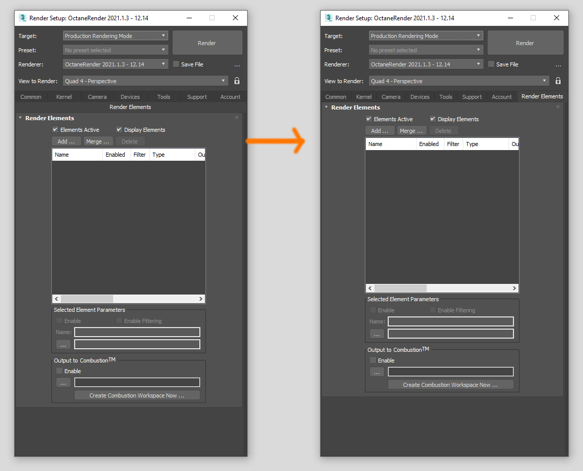

Thanks Paride...
I just discover that Render setup window is resizable.....
So render element tab wasn't visible !!!!!
I thought it was removed by AOV...
And I was soo in a hurry and without sleep...
