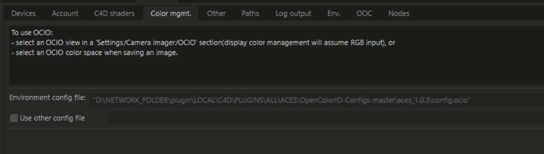

To make our aces workflow easier we try to use the environment variables that come with OCIO.
It looks like Octane is also supporting this, it recognises the environment variable (see screenshot) but can you can't select a color profile afterwards.
Can somebody please tell us what we are missing to get this working please?
We use the environment variable called: OCIO
https://opencolorio.readthedocs.io/en/l ... _ocio.html
Ocio path - Environment variable

According to your screenshot, it appears to be working.

Yes it looks to be working but it does not detect it when you try to select a color profile or try to render something.jayroth2020 wrote:According to your screenshot, it appears to be working.
Can you please help.

Okay never mind! I got it working. I needed to remove the quotes!
