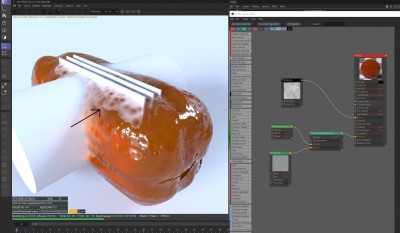

I am trying to make a super realistic jam material and I thought to link a 3D noise to the density of the medium but I don't know exactly how to do it... Is it possible?
the effect I would like to recreate is similar to this image, as you can see the light inside the jam diffuses unevenly
Thanks!

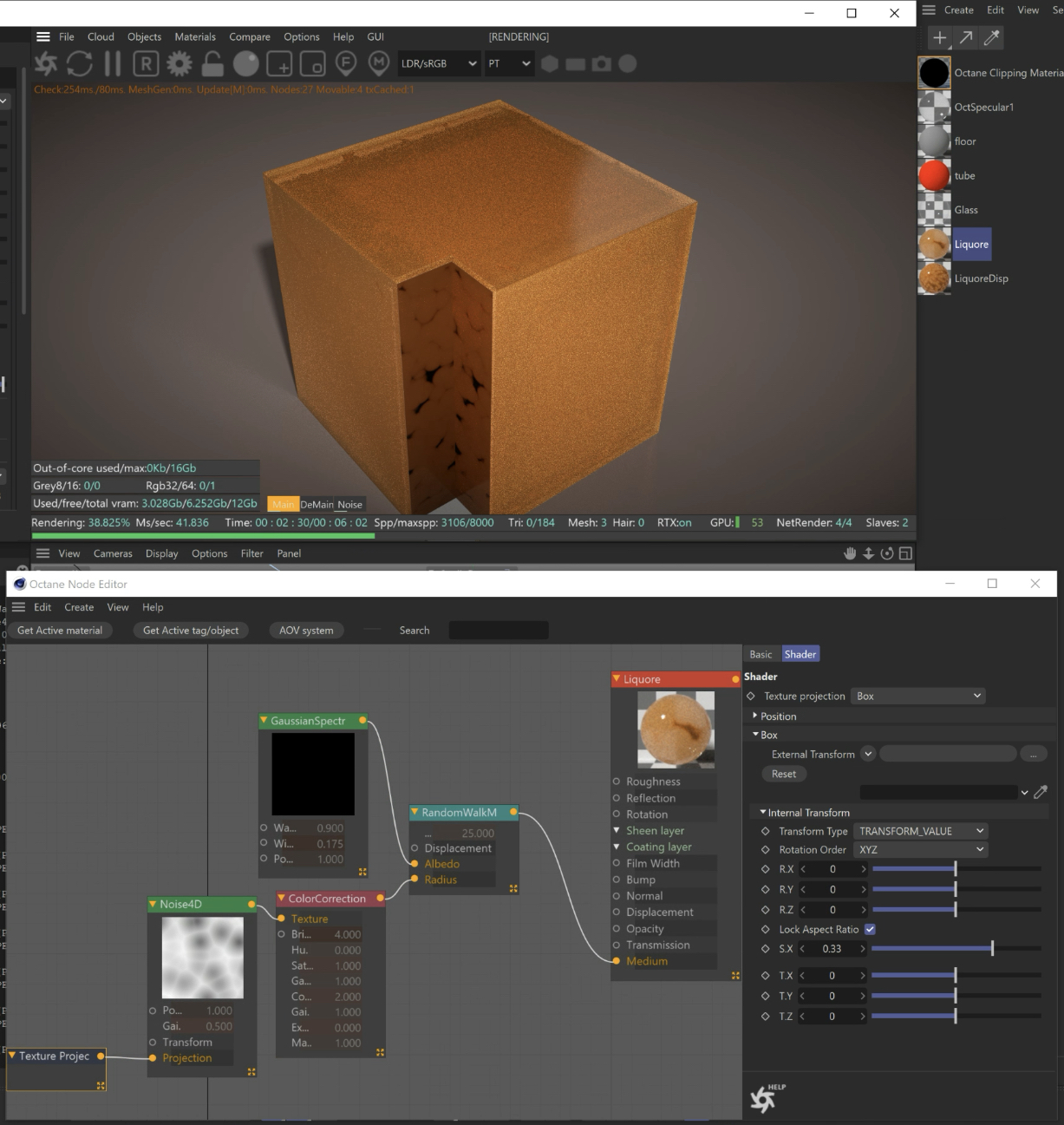

try to play with the Random walk Medium node in a Specular material, with a 3D Noise node in the Radius pin:

Hi Beppe!
I have already tried this way but the noise seems only superficial and not volumetric, in fact you can also see the seam of the cubic mapping.

It seems to work in 3D space here, try to create an Octane Box Projection node:

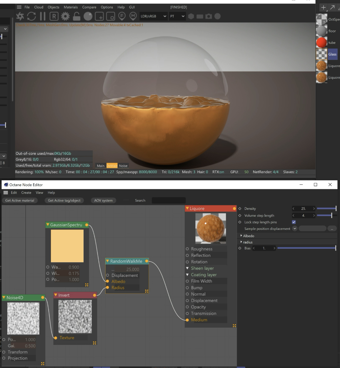

Hi Beppe,
Sorry to be annying, but it seems not working by me.
As you can see, clipping always shows the same texture, which would have to change if it were volumetric.
Maybe I'm doing something wrong...

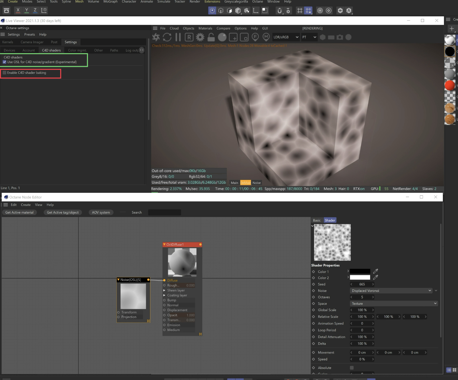

Ok, try with a native C4D Noise, in Texture space, and make sure that only the OSL translation is active in c4doctane Settings/C4D Shaders tab:

Oh yes! Now it works!
Thanks a lot for your help, I guess it didn't work for the "C4d shader baking"

Yes, it cannot work if the C4D Shaders Texture Baking is active, because the Noise stops to be procedural, and you will see a tiling effect at uv borders.
if the OSL only option is active, the C4D Noise stays procedural, and you have not any tiling effect.
