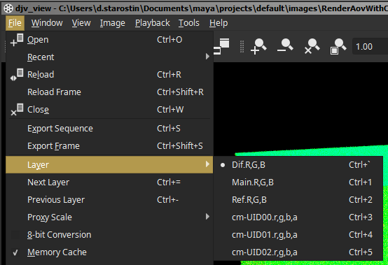

Maya can't save some AOV's when exporting Cryptomate.
The same bug that was fixed in Houdini plugin?
"Fixed saving of AOVs that was ignoring non-cryptomatte AOVs after the export of a cryptomatte AOV."

Vyoor wrote:Hi!
I can't reproduce it, it saves all layers in my tests, not only cryptomatte.

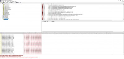

Code: Select all
The specified module could not be found. (OctanePlugin)
I have see one other guy on the forum with the same issue :
viewtopic.php?p=408684#p408684
Like me when it go back to previous version, it does work again. 2020.2.4 - 19.17 in my case
I bet that both our systems are missing a .dll or an env path.
- is there a set of env var that could be check ? the doc doesn't mention any.

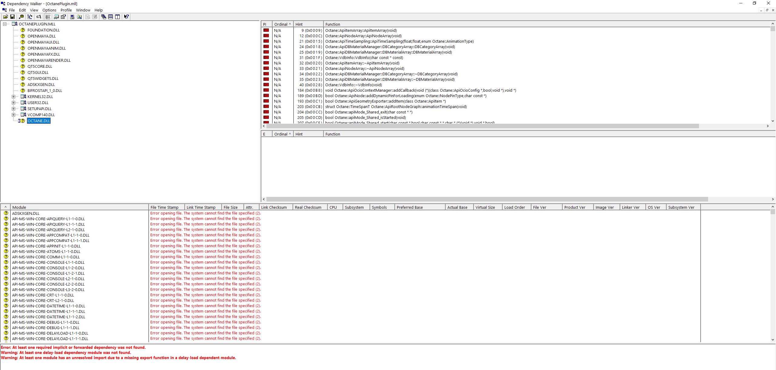

- is there an equivalent on windows of the ldd command. I could try a
Code: Select all
ldd C:/Program Files/OctaneRender VRE for Maya/2018/plug-ins/OctanePlugin.mll
to check if there are missing dependencies.

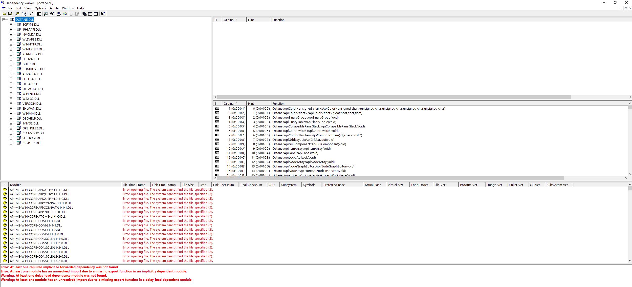

EDIT:
it looks that windows doesn't have ldd by default, i have use dependancy walker instead :
It looks to miss something.
I haven't install bifrost because i don't need it. i will try to install it just to double check that it doesn't affect octane.

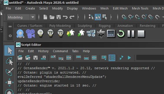

Problem solved, i can confirm that the fact that bifrost was not install was the source of the error.
After bifrost install, octane start without error.
It looks that the tree of dependencies has change in 20.12 and 20.10 compare to the 19.17
now xgen and bifrost are directly linked.
that's weird that bifrost dependancies broke octane install as it doesn't look to be supported by octane ?
viewtopic.php?f=28&t=79245
JimStar
Posts: 3852
Yes, unfortunately Bifrost guys don't provide static libraries in its SDK, so it must be installed even if you don't use it and don't have its license.
