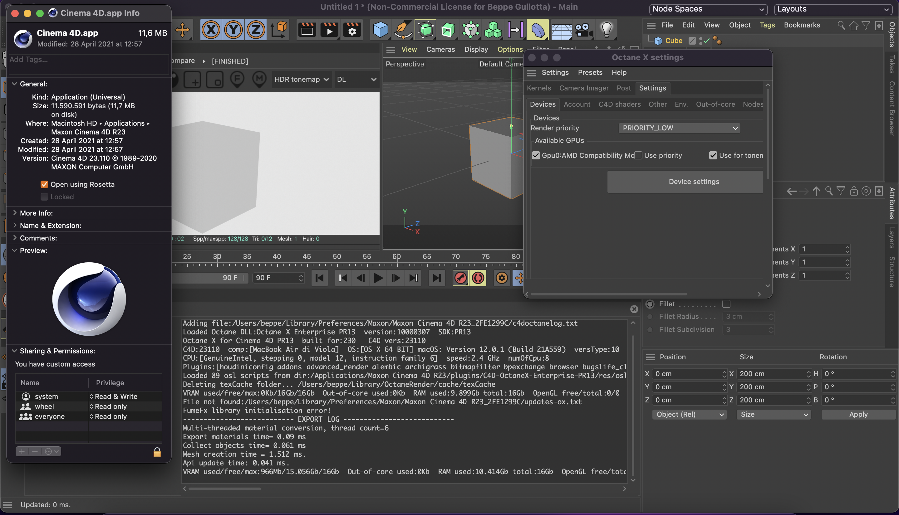

please go to c4doctane Settings/Devices panel, and enable the GPU also for Tonemap, or the render cannot start:

make sure to have installed the PR14 version, and if not enough, try to delete the oct.dat file, at the following path, then restart c4d:
`/Users/UserName/Library/Preferences/Maxon/Maxon Cinema 4D R23_XXXXXXX/prefs/oct.dat`
