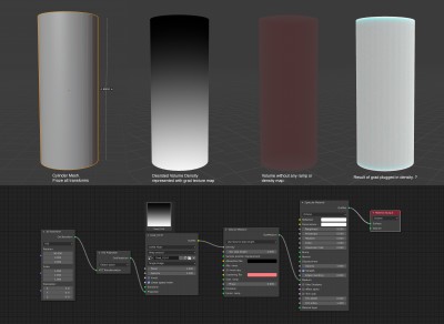

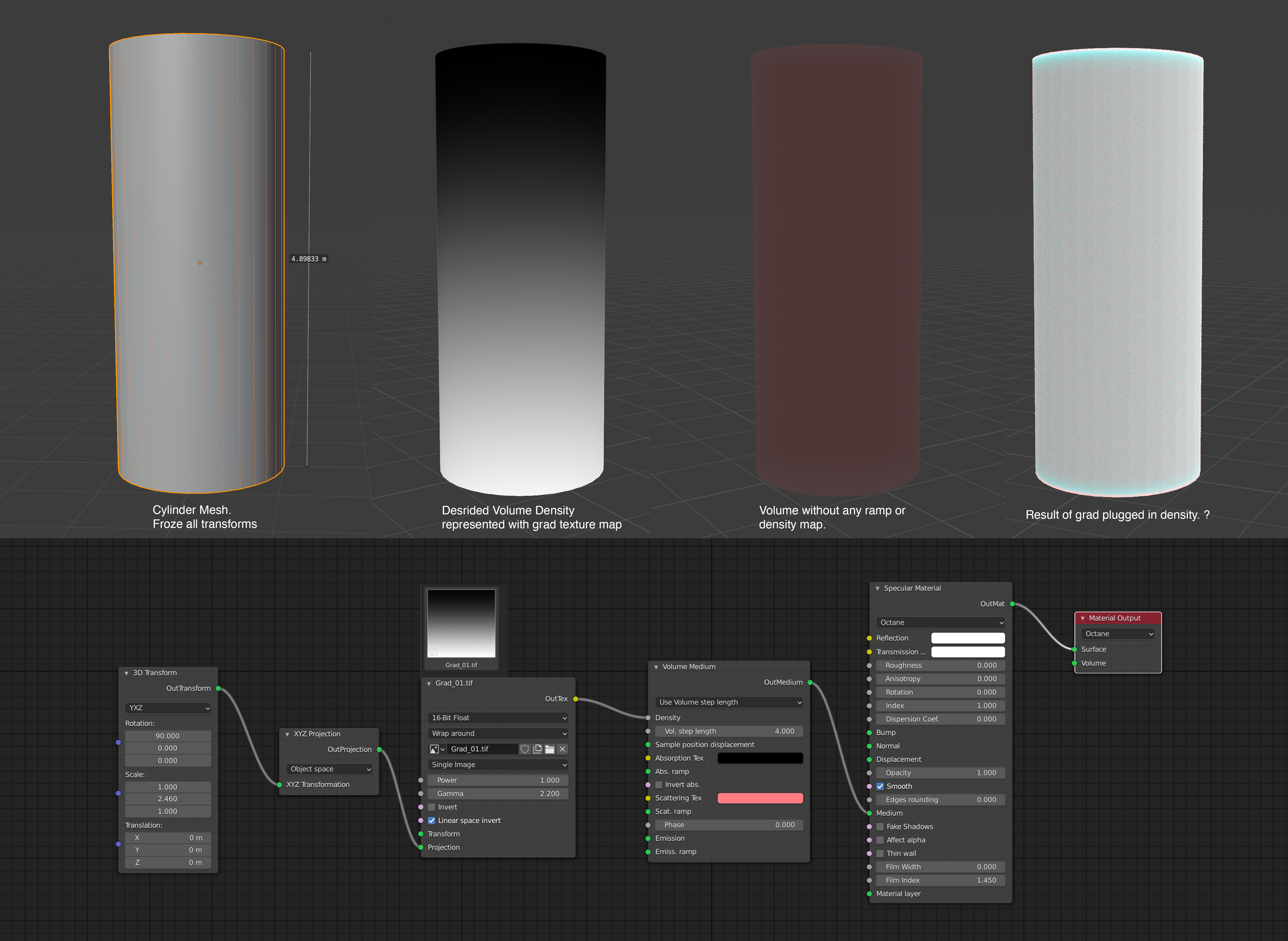

I've been trying to create a gradient in a Volume and can't seem to figure it out.
I tried the "Volume Ramp" also (which doesn't seem to do anything either) via "Density", "Scattering Tex" or "Scat. Ramp" and no changes take place.
I would like to use the same approach to add noise to a Volume but when I connect a "Noise Tex" in the Density, nothing happens either.

In the normal Volume medium node the Density property is a single number not a texture, it looks like Blender lets you plug a texture there but it is converted into a single number and will be the same for the whole volume. In Octane 2022 there is the new Standard volume medium, there the density is a texture and you can have a gradient controlling it. In earlier versions you will have to combine your gradient/noise with the absorption and scattering. It should be a 3D gradient or noise though, the volume density exists at any point in space inside the volume bounds so the gradient texture must be able to produce a value at any point.

Thanks for your reply. I'm trying to create a Volume Fog with a vertical Density attenuation falloff driven by a vertical ramp/gradient.
I would also like to drive the absorption with a color gradient, where the thicker the fog, the more of a color is absorbed, and the thinner it is, the more of another color is absorbed.
Would also like to do the same for the Scattering Tex/Ramp as the documentation and naming of the widget suggests.
At this current time, all gradient connected to either, Scattering TEx/Ramp are brought down to a single color, which seems to be the median of the provided ramp.
A gradient from Black to White plugged in the Scattering Tex, or Scat. Ramp creates a 50% grey Scattering value for example... Although the documentation says otherwise.

That's not going to work with geometry. You would need a VDB volume with the shape of a cylinder.
