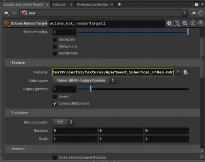

I'm using Octane Enterprise 2020.2.5 23.11 stable, I use it for Blender also, latest version for Blender build.
I tried using the Render output in material tab and it's the same. I have to change imager gamma to 2.2 to make the hdri backplate appear normal, but lighting is still the same.

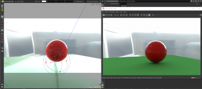

I tried setting tex environment to non color (defaults to linear unless it's using previous settings for that hdri) unchecking linear srgb invert (checked by default) gamma 1 in tex env. tab, and in imager. I think the lighting looks okay, but the background light still seems blown out (see screenshot). Maybe I'm just used to Filmic in Blender clamping the highs

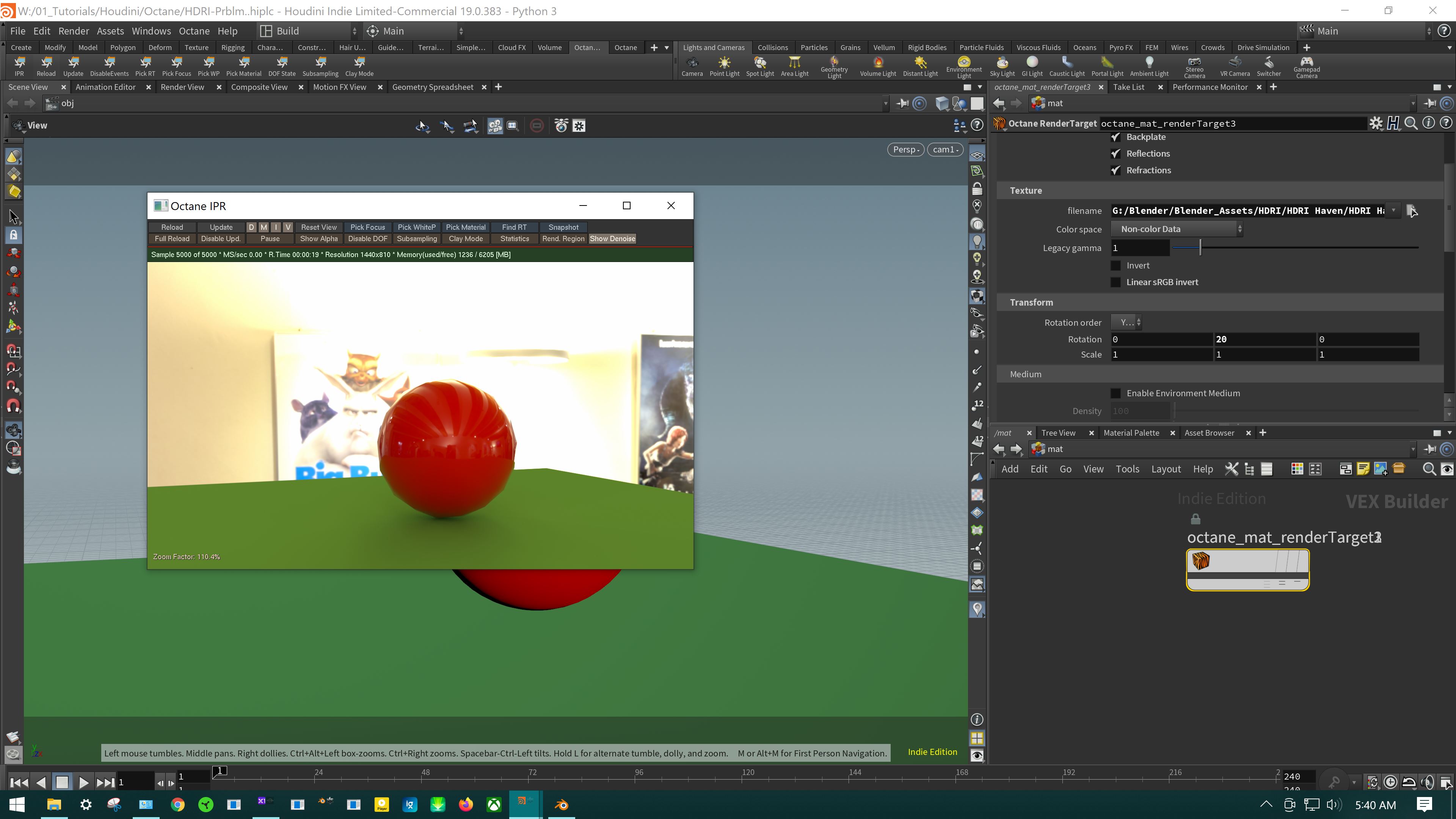

If you have a float HDR image, the right color space for it can be non color data, or linear srgb + 1.0 gamma. As you can see in the attached image, this configuration matches the Houdini environment light background in the OpenGL viewport, so I think that the Octane rendering is right. I'm not sure why you can't match the rendering in the Blender plugin, to be honest.
