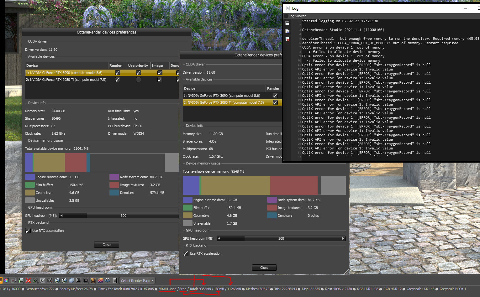

hi - does octane load geometry that is only visible to the camera, or does it load the entire scene? I am having stability issues and error messages while trying to render some archviz work -

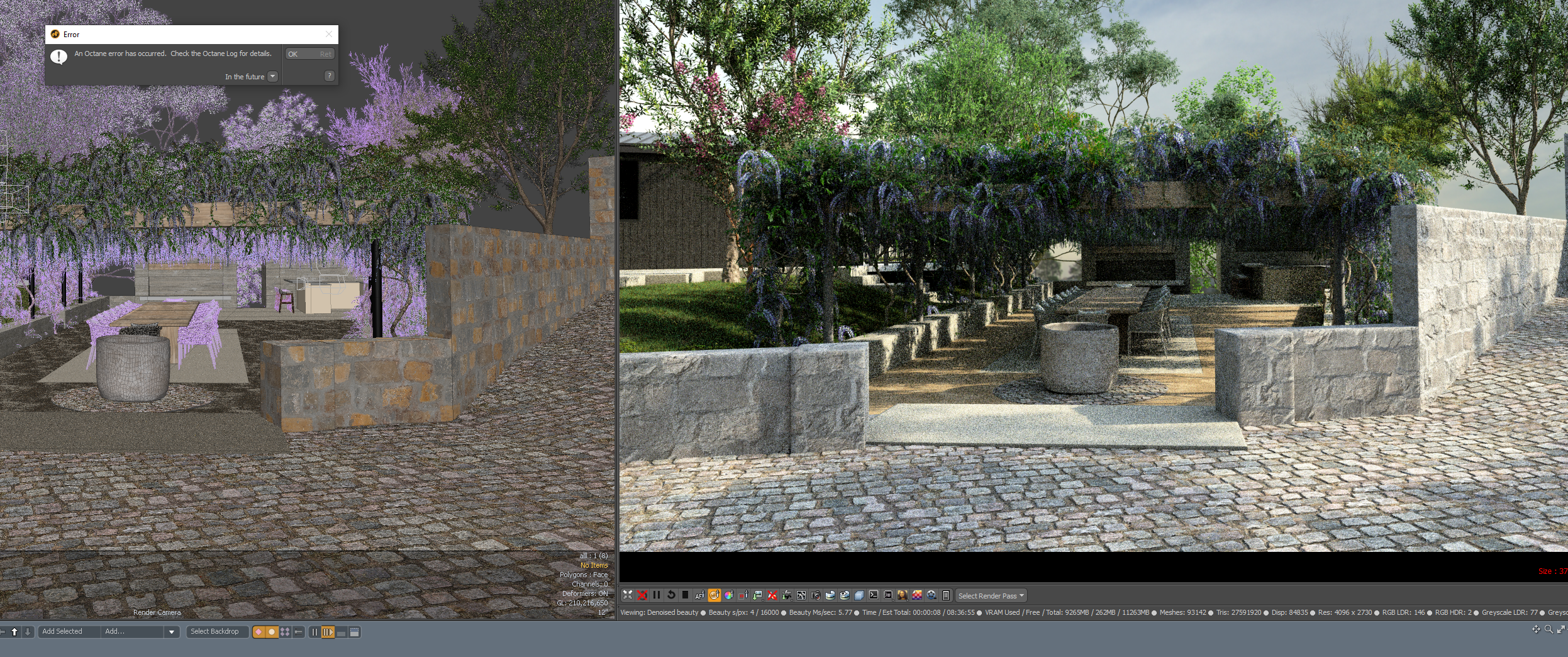

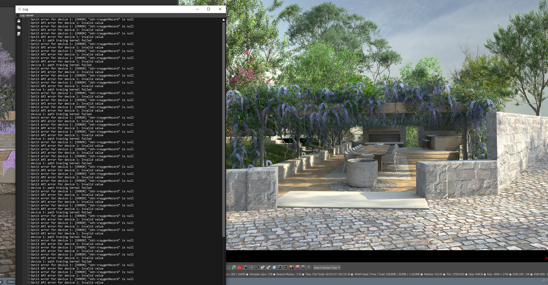

when I try to make changes while its rendering, I get a error message, but it still makes the changes and keeps rendering - but the log shows a string of the same error -
I would ideally like to figure out my theoretical limit in polycount given my total vram is 35 gigs - or does it work differently?

No it loads everything outside of the camera's view (but it doesn't load items hidden in the item list).jwfvr wrote:hi - does octane load geometry that is only visible to the camera
It doesn't work that way, because geo/textures need to be present on both cards while rendering. You will be limited to 11GB in your case. If you disable the 2080 Ti, you will be limited to 24GB on the RTX 3090jwfvr wrote:given my total vram is 35 gigs - or does it work differently?
The error at the top of the log in your screenshot tells you, you are running out of memory (not enough free memory to run denoiser etc)jwfvr wrote:I cannot figure out if this is an error or if I am just running out of memory
You should just let the denoiser run on 1 card in your device settings. If you have a large scene which needs more than 11GB of VRAM, you can disable the 2080 Ti completely.

Correct. If you had 2 of the same cards (and they support nvlink), you could nvlink them together to get roughly the combined memory of both cards (so 48GB with 2 x 3090s nvlinked)jwfvr wrote:ok got it - but this decreases my render speed, so I have to trade speed for memory in larger scenes?
