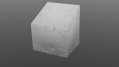

So I have some polygons and some curves within one Mesh.
Polys have material A (with texture displacement) and curves have material B.

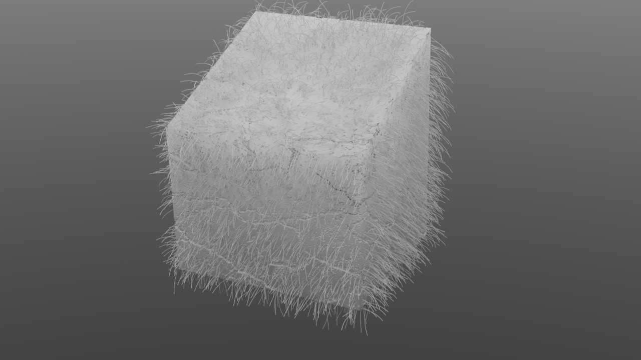

I'm using a Bend Effector on the mesh to animate it. As long as I try to render a still images - the bend effector, the displacement and the 'Render Curves' works fine.

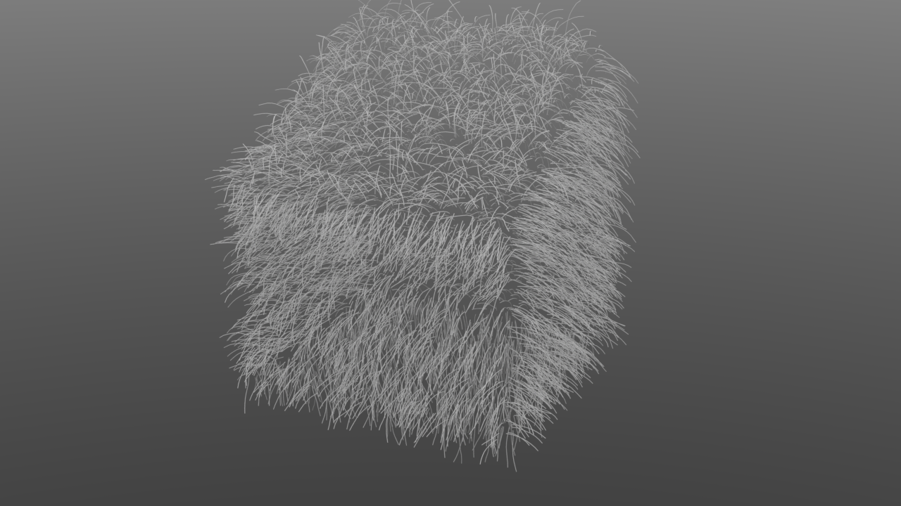

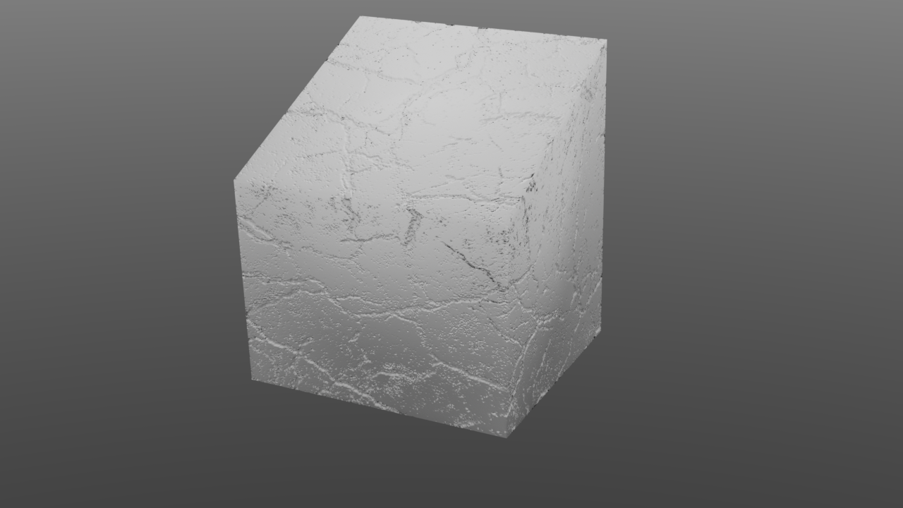

But when I try to render an animation, or if I change the camera view - basically anything that makes Octane's viewport reload - the mesh dissapears :cry: I'm left with just the curves. If I turn OFF the "render curves" parameter - my polygons come back, but I dont have the curves anymore. This looks like a bug of some kind.
Yeah I know that I could separate the curves to a different mesh, but the problem is I have a bunch of different Effector already applied to the mesh and I would need to apply them by hand all over again to just the curves. Which would take way too much time that I don't have right now :/
Not sure what is the problem here - I was thinking that it's maybe the displacment, but when I got rid of it nothing changed, so I guess it's not that.

I am pretty sure that if there are any curves on a Modo Mesh item, then the polygons will not render in Octane (only the curves will). So you will need to split the mesh into 2 (which I understand you would prefer to not do). Unfortunately it a limitation of the current plugin.
