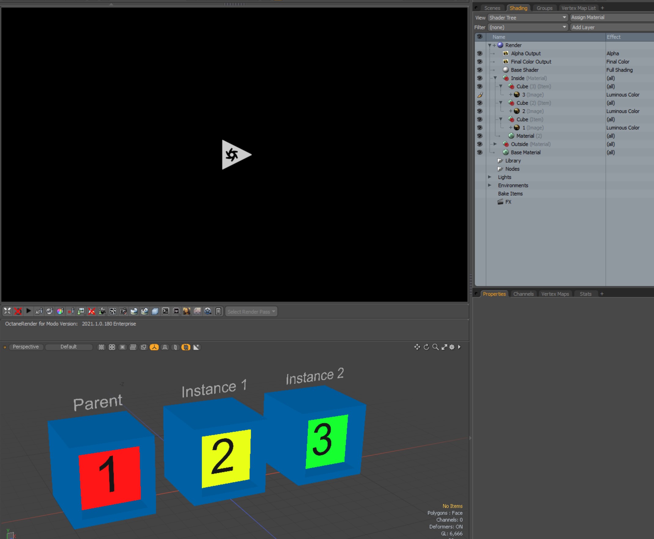

I'm trying to use a texturing method that I've used previously with Modo and V-Ray but it's crashing Octane.
I have a parent mesh item with a material and then instances of that mesh item. In the material group I use item masked sub-groups to give different textures to the parent mesh item and the instances. Can this work in Octane? Or is there a different approach I might try?
In the attached image you can see that the "1", "2" and "3" are texture maps targeting specific items. If I launch Octane with this setup, Modo just crashes.
Item masks and Instances

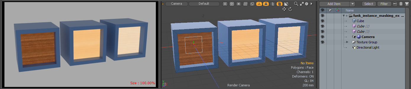

I think there is a different approach in octane: All the instances have a particle id. In the material you can access these particle id with a particle id texture (i hope thats the right name) and use this to mask your textures.
While this shader tree setup won't work in Octane, it shouldn't be crashing. Can you share a scene where you're seeing a crash? It's not crashing here.
Octane requires a different approach, which is a bit more complicated. I have attached a sample scene.
You need to give each instance a unique value in Modo Item > Channels > Particle ID. My example has the parent mesh set to 0.0, cube (2) = 1.0, cube (3) = 2.0
You can then use an "Octane Instance Range" node as a mask, plugged into a gradient, which you feed your textures into.

Thanks Hesekiel2517 and funk, I suspected I should be using the ID approach but didn't really know how to do it so thanks for the explanation and scene.
I wasn't confident that the item mask approach was possible but thought I'd give it a go just in case. I guess there's gonna be a lot of ex-vray people getting used to working in Octane
I've attached my test scene if you wanna see if it crashes.
Thanks,
Will
Thanks,
Will
