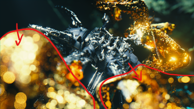

I was wondering if someone knows how to remove grains from camera bokeh? no matter what I do in my scene just the bokeh still grainy, have a look at my image I attached please

While adaptive sampling would help in optimizing the render speed - fixing this is ultimately down to increasing Max Samples. I'd recommend turning adaptive sampling on and increasing samples until either render time is at it's maximum viable cost or the noise is resolving at a decaying rate. At that point any remaining noise can be handled by the AI Denoiser.
Bokeh is one of those "expensive" effects in path tracing that some still fake in the compositing stage.
