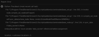

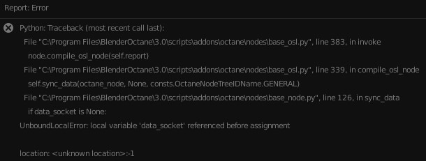

I just realized there actually is a newer version of octane blender and it is a litle more broken than the last. The vectron node when attempting to compile OSL now spits this out at me...
One thing I noticed is, the samples that the author included load with the old nodes and 3/5 of them work. The other two dont. When I did it from scratch with the new nodes in 2.93 octane blender, only the mandelbulb worked. Now in 3.0, none of them work, all giving me python errors in the osl. I am going to review that code tomorrow because it looks like at least the OSL problem is python related. Looks like the data_socket variable is being called without any prior assignment. I am just taking a quick peak at it now but the problem is that it has an if statement on data_socket but the variable is set within the if statement so it has no way of doing anything with it. I will try to figure out a fix for this a bit later but I am not 100% sure what is setting the initial state of data_socket in the first place so it may take a bit of tinkering with and I am a bit rusty with python so well see if I can actually do anything with it. Haven't used python heavily in about 6 months now. As for crashing even in stand alone and why even on the old node it didn't work, I think that has to do with octane it's self
